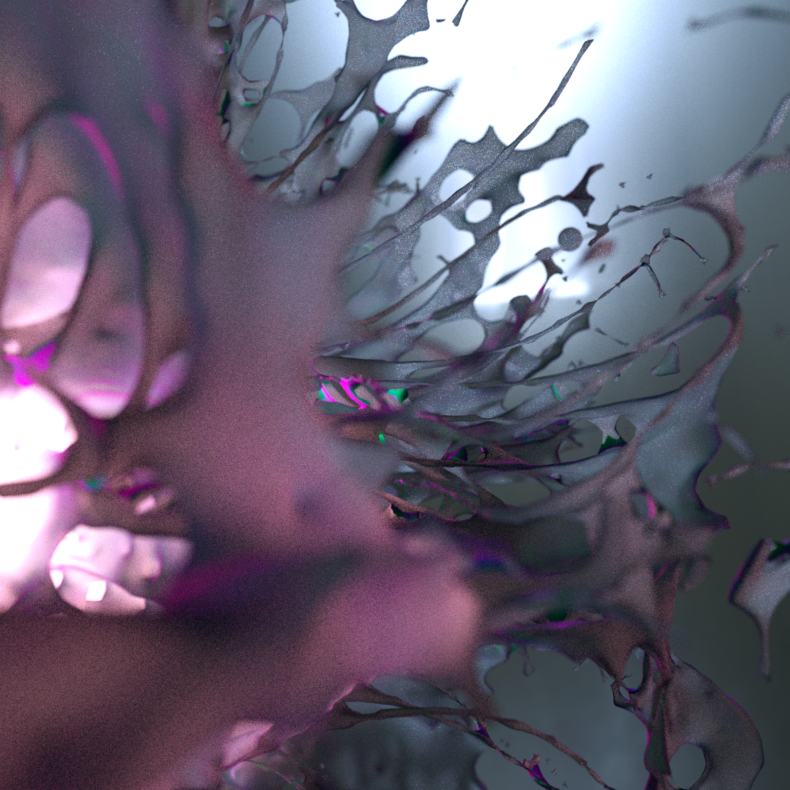

I've been experiencing a weird issue, dunno if it's something with my setup, or if it's a setting somewhere, but I've been experiencing a noise block on my renders, even after rendering loads of samples. Saving the image after rendering, still has the noise block. Here's a reference image:
Any idea why this is happening? Is this because of my different models of cards? Any help would be wonderful!

Ok, it doesn't seem to be a net render issue but an issue with the GTX 1080 with this scene.
This is a render at 500s/px with only the GTX 1080 running:
This the same render on a GTX 980 and a Titan Black:
As you can see in the first image there is some invalid noise in the 1080 rendering, which seems to be worst in the top right tile. I don't know what the reason for that is, but it's not network rendering since I disabled it for the test.

I finally got around to properly investigate the issue and it's that same as this one: viewtopic.php?f=9&t=55380
Until the next Octane release is out, you could use either path tracing or direct lighting with mode diffuse GI. The problem affects Maxwell and Pascal GPUs.
