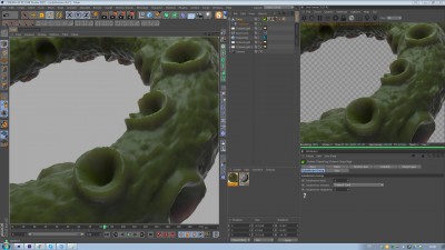

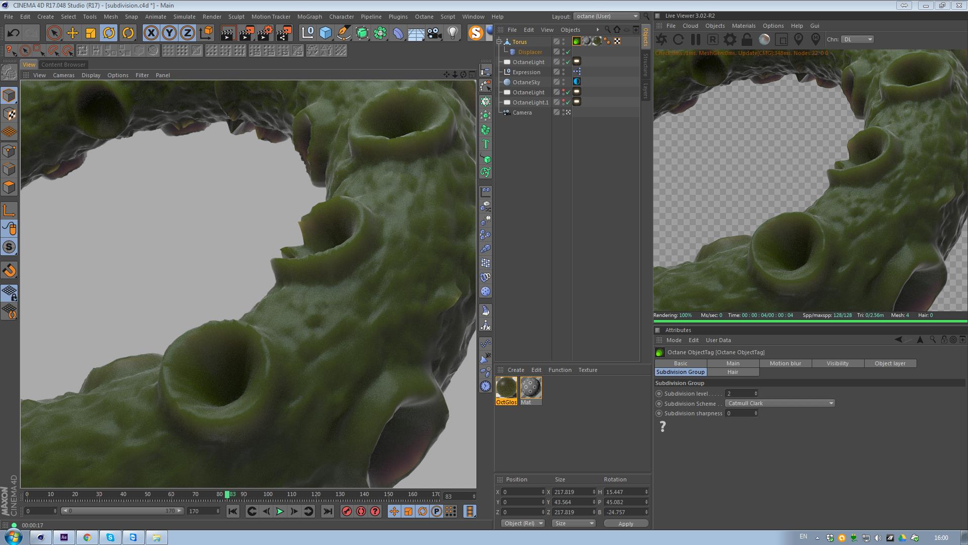

As you seen in atachment preview window shows proper subdivision and render viewport doesn`t. The external render faced the same none-subdivision error.
It seems that subdivision in final render doesn`t affect to model at all. I couldn`t figure out how to deal with that.
I can use cinema 4d Subdivision Surface modifier, but it`s interesting why octane`s subdivision tag brings this kind of bug.

Not A BUG. Don't use "SEND ALL DATA". Otherwise objects will not be movable and loose object tag property. Please read this section and object tag section. And ask if you need more information.
https://docs.otoy.com/#60Animation%20rendering

thank you oaktar, i missed that line in help
