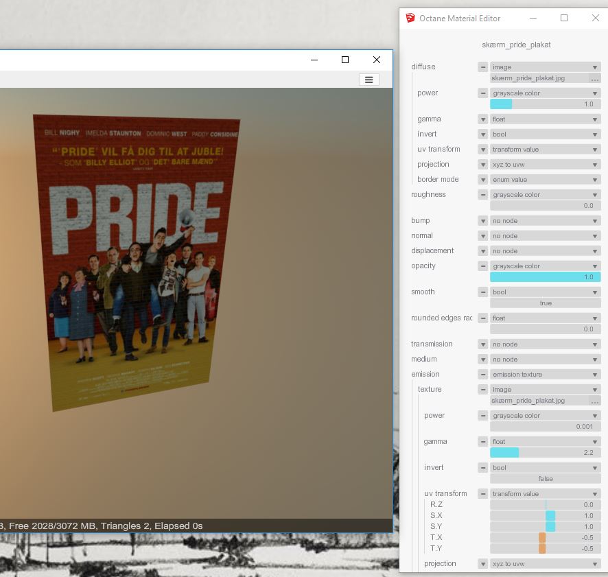

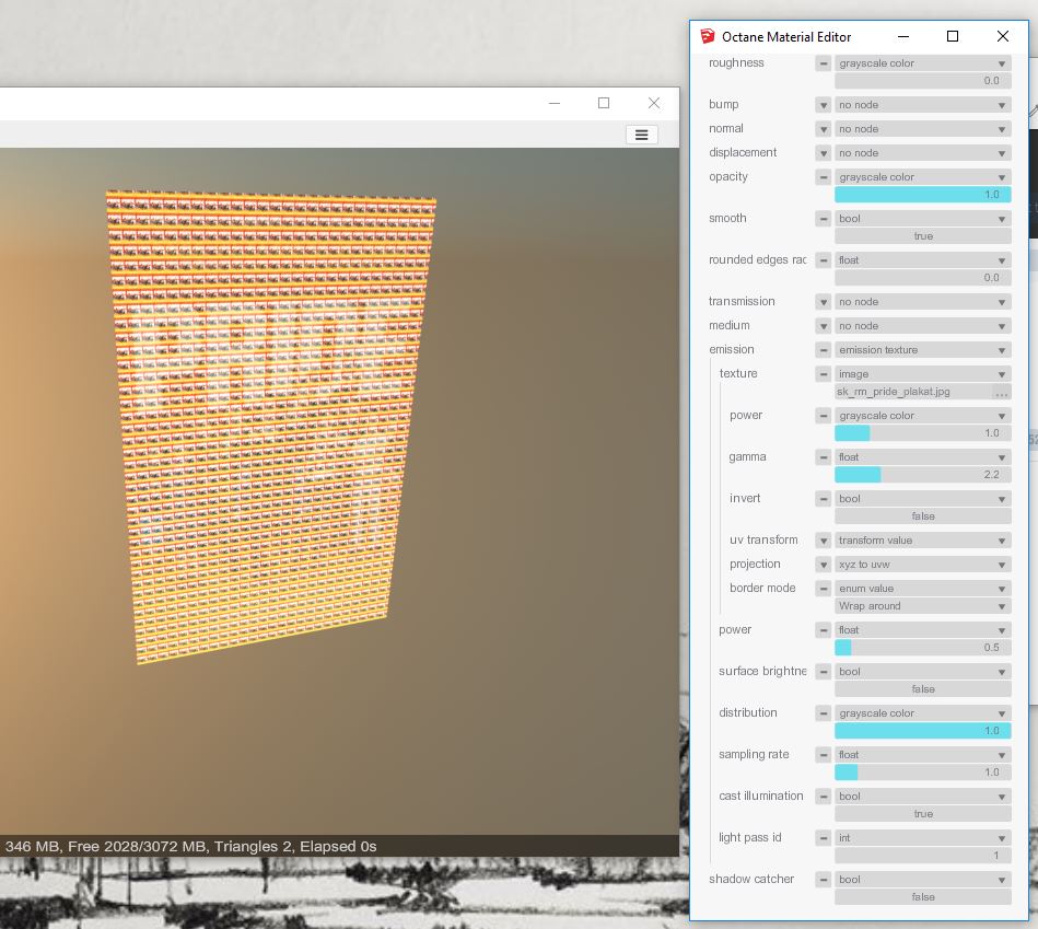

i'm trying to create a TV screen by converting a sketchup material to an octane diffuse material, and then adding an emission texture > texture > image and then select the same image as in diffuse - but then the scale is all wrong and i have to fiddle around with un transform s.x, s.y, t.x and t.y.
am i'm doing it wrong? is there a easier way? - i'm not having this issue in 3ds max.

There have been some issues with scaling of textures in the past. It could be possible that we need to expose more options on the editor. I will take a closer look at these screenshots and see if this is the case.
