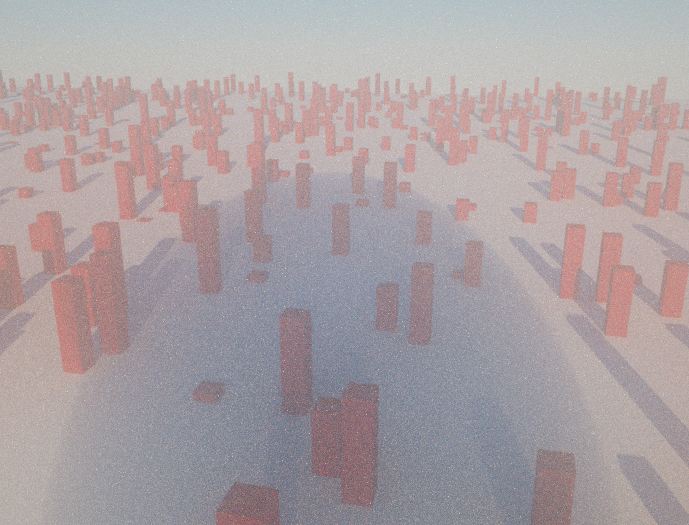

haze wrote:I think the problem is likely the Medium Radius on the Daylight Environment - the environment medium is basically implemented like a sphere around the camera anyway, so you need to set some Medium Radius for the sphere that works for you. Please let me know if that still doesn't solve the problem
Hi haze, by the way that sphere is actually casting a shadow. Sometimes a rather HUGE shadow across the whole scene.
EnvMediumShadow.orbx
(7.41 MiB) Downloaded 255 times
(Orbx is from 3.03.1, you'll have to uncheck invert absorbtion in 3.03.2)
