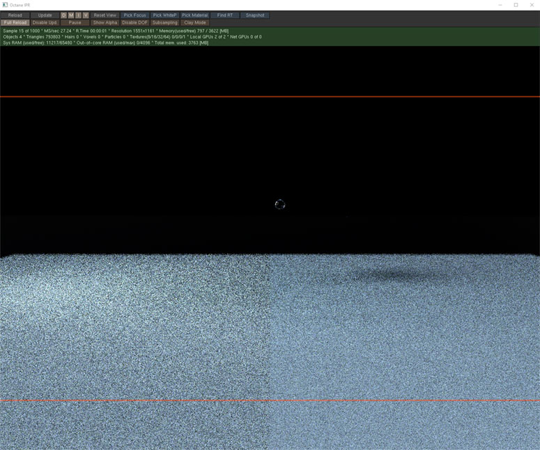

Vertical split in brightness at render time

I'm having a nasty issue while rendering a scene. See attached image - there's a vertical split going through the center of the image. No difference whether I use a single or two GPUs. Any ideas what could be causing this? This is obviously making the final render unusable
Edit: it's not the materials - the issue is visible in Clay mode too
Weird issue ... in the attached image you only have computed 15 samples, but I suppose that the problem is there also with more samples.
Can you please send to me this scene to know your scene configuration? It seems a problem with the the tile rendering, but I've never seen it before.

Unfortunately I can't send the actual scene but I'll try to send a similar with the same issue.
I was so far able to narrow it down as to be most pronounced in Path Tracing. You can see the brightness switch between each sample step. It's not noticeable in PMC mode.
While the rendering is in progress, it is normal see this effect due to the tile rendering, but the sampling should be the same in all the image surface after reach the kernel samples, once the rendering is finished.
If you get tile artifacts in the final images, after reach the kernel samples, we can have a bug in Octane. I am testing a simple scene here, something like your plane, but I can't reproduce the problem.
