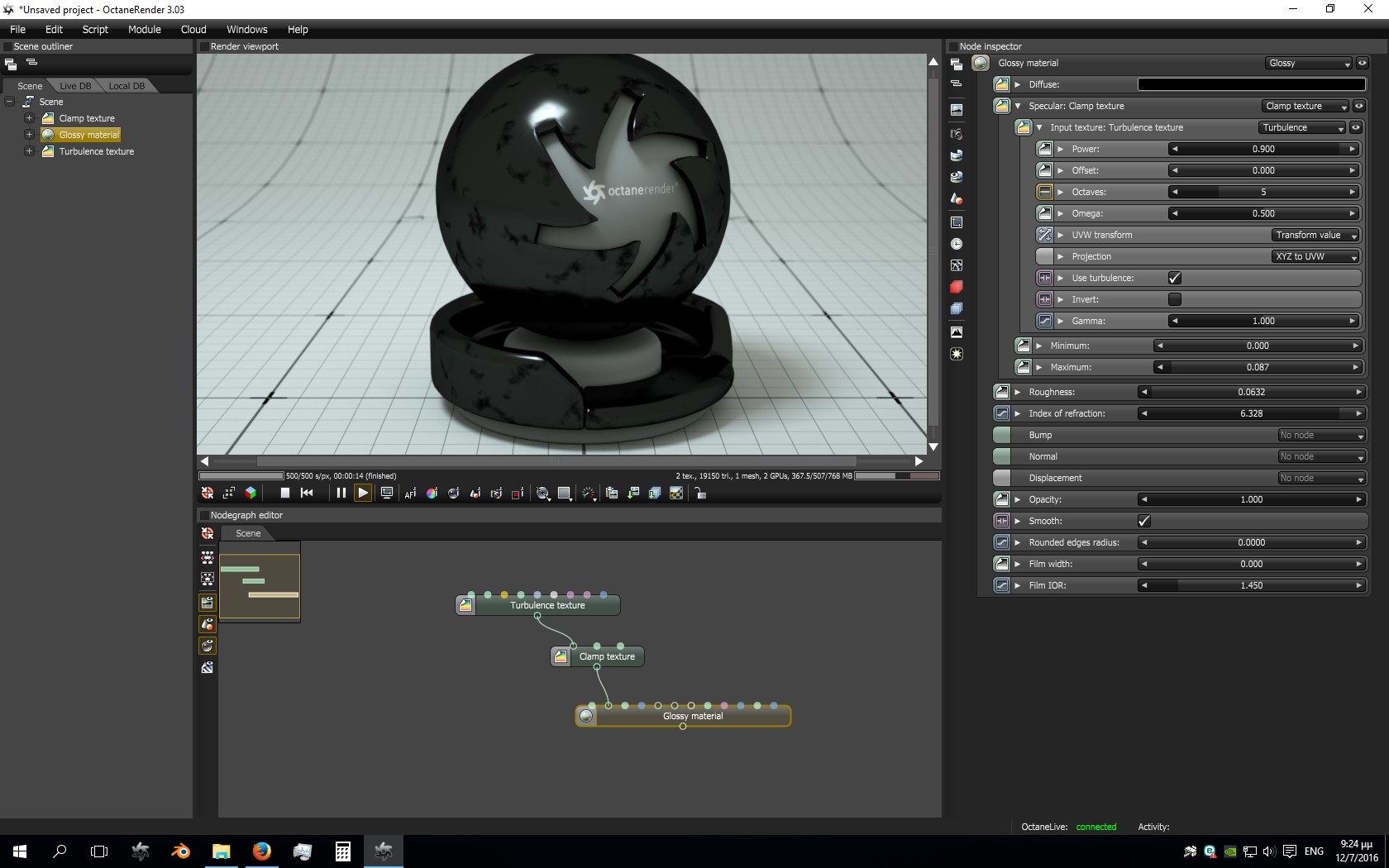

How do i get a wet (condensation) look on object?
-Like in this Andrew Price Tutorial for blender Render
Around 13:45 min
https://youtu.be/ivqRhnZu_kQ?t=13m45s
Is this possible in Octane Render For Blender?
how do i set it up with a texture or...?
Thax
- Synthercat
- Posts: 284
- Joined: Mon Aug 30, 2010 11:12 am
- Location: Thessaloniki Greece
I didn't had the time to watch more that 2-3 minutes of the good ol fella Andrew but I am pretty sure it's easy to do with Octane too
Use the texture and if needed tweak it with ramps n stuff... here's a sloppy experiment I just did with clamp :
