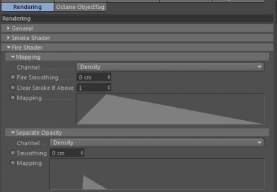

I looked around but found nothing on this. Maybe it's been covered already?
Is there an Octane equivalent to applying TFD's Separate Opacity mapping to channels? Even a simple gradient based on luminance perhaps, for Absorption, Scattering and Emission channels?
The only control I see for opacity is more of a global control using Density and Volume Step Length, which does not allow for lowering or increasing the opacity in specific light or dark areas.
Thanks!
brasco
Posts: 198
Joined: Wed Apr 13, 2011 2:56 pm
Yes, they're called Volume Gradients and they go into the Absorption, Scattering or Emission Ramp channels.
Should note that this is not a 1:1 translation of the TFD curve and you should play with the Max value parameter to find a good range for the gradient to affect.

Thanks for the feedback. That was the first thing I tried actually. I will give it another go. The range might not have been correct for my needs. Thanks.

In relation to the original question I managed to get the transparent to opaque result in the Emission ramp. What was tripping me up was the Absorption really needed to be black as to not be an issue, the Scattering mostly black as well.
