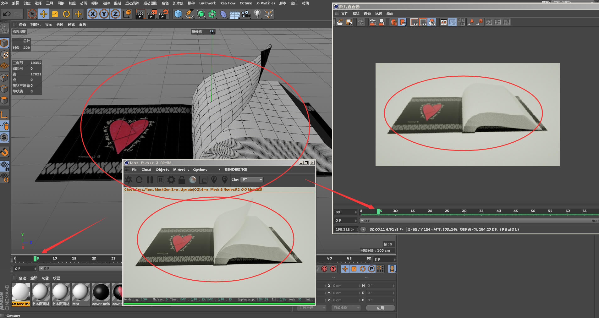

Play time line is no problem, live viewer is not the problem but the rendering to picture viewer is first the problem and 15 frames have had no prior animation and 15 frames after a variety of animation problems! please help me!

i send you thank you ! open the scene , and render all frames The result is not the same as the animation in the window.

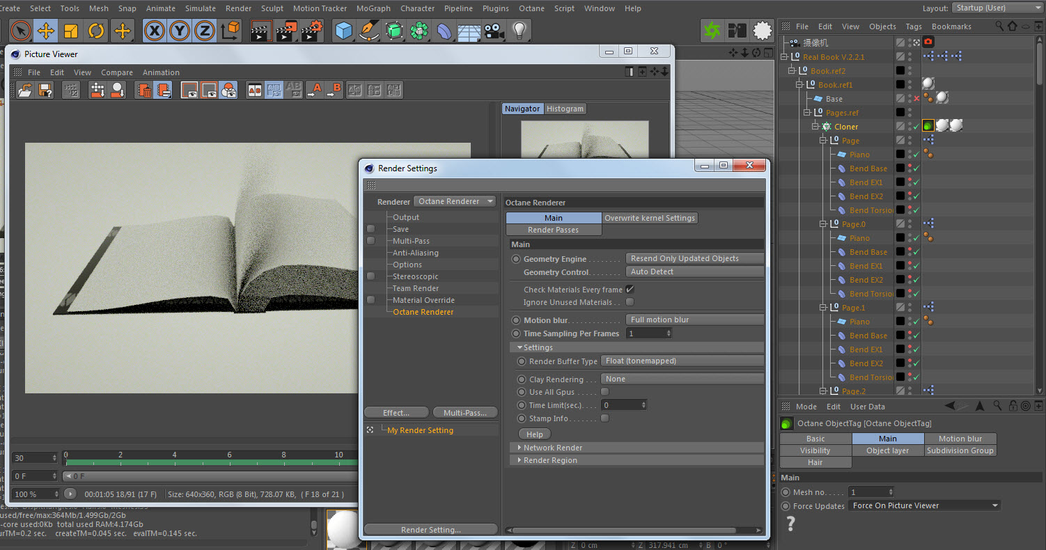

Thnx for scene. I notified that there is a problem between update detection engine and your setup.
1-disabling cloner will help
or
2-making "force on picture viewer" helps
see image

Btw don't use object tag on everything. just put on top object of group.
