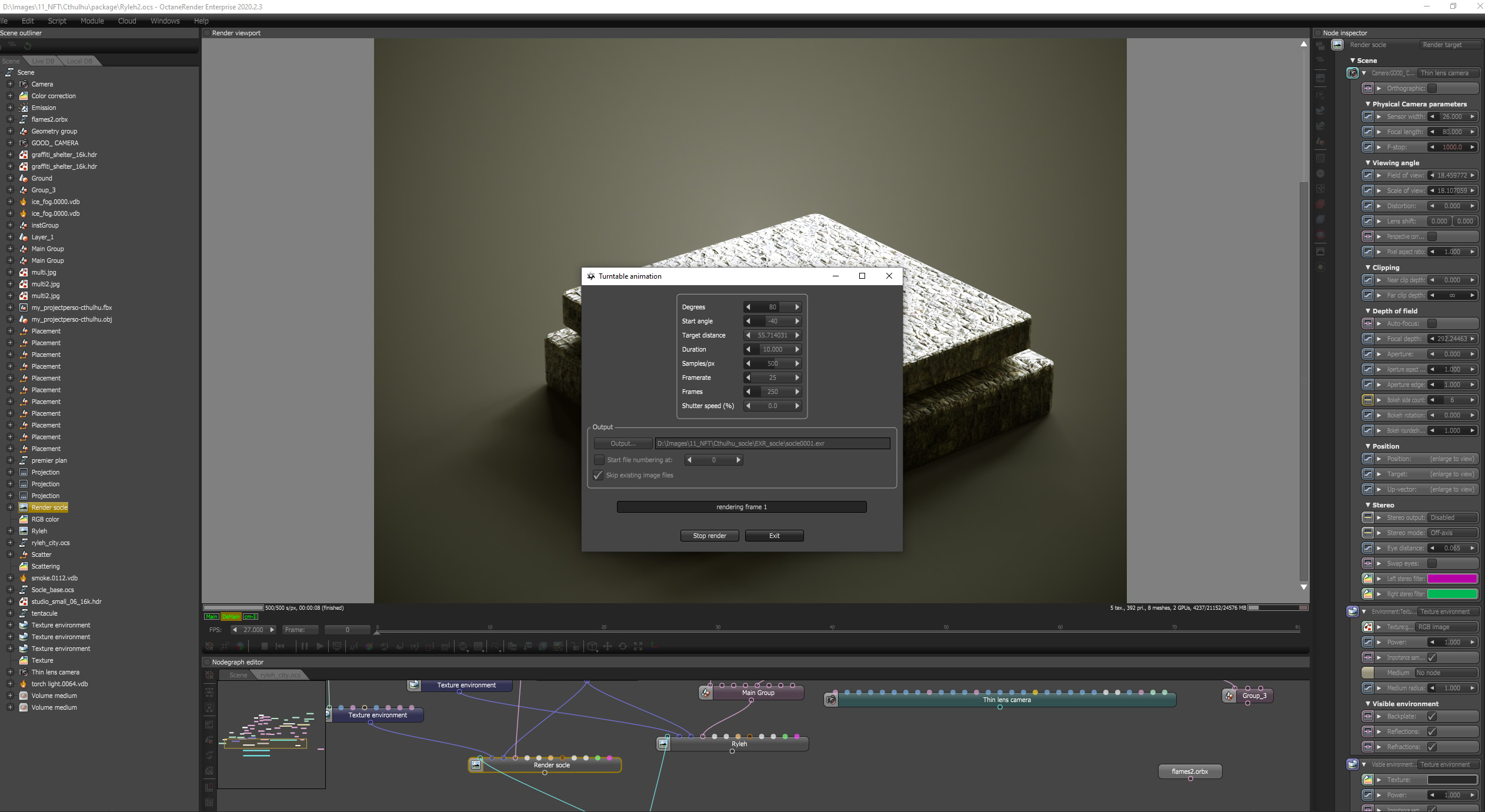

MarcSImonetti
Posts: 6
Joined: Thu Jun 11, 2015 7:44 am
Thanks a lot for your fast answer!
I've just updated to the last version 2020.2.3 and I've got the same issue.
The first frame has finished rendering in the viewport, the turntable animation box is frozen on rendering frame 1, and the destination folder is empty.
Thanks again!

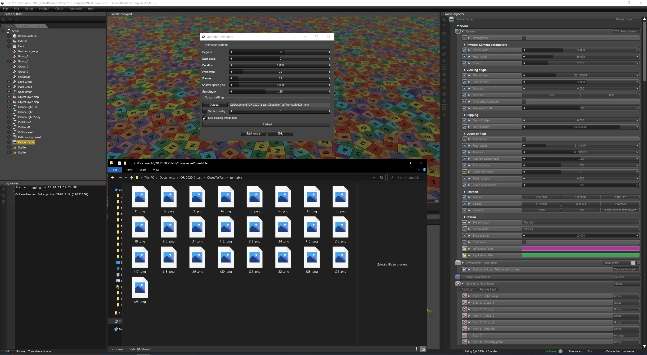

Posts: 10433
just tried with 2020.2.3 + Turntable script, and everything has worked as expected:
Please share a screenshot of your Turntable settings.
ciao Beppe

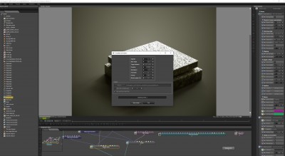

Posts: 6
Thanks a lot for your answer,
Here's my screenshot:
