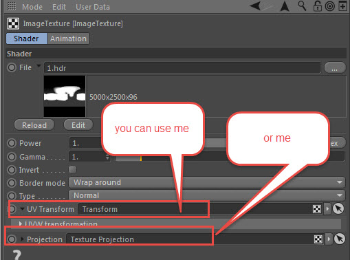

I am having an issue with the inability of the Environment tag to adjust the RotX or RotY of the image if the image is nested within a Color Correct (and perhaps other type of) node. The controls are useless, as they refer to the immediate node, instead of the texture contained within the node. Yes, I can color correct outside of Octane and Cinema, however, a major selling point of Octane is real time look development, which is issue impacts. Are there any workarounds for this limitation, or is it an actual bug?

It's limited by one level. See image how to do by your self. "Rot" values are applied here actually by plugin. Nothing else more.
