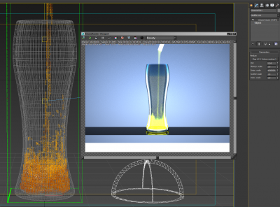

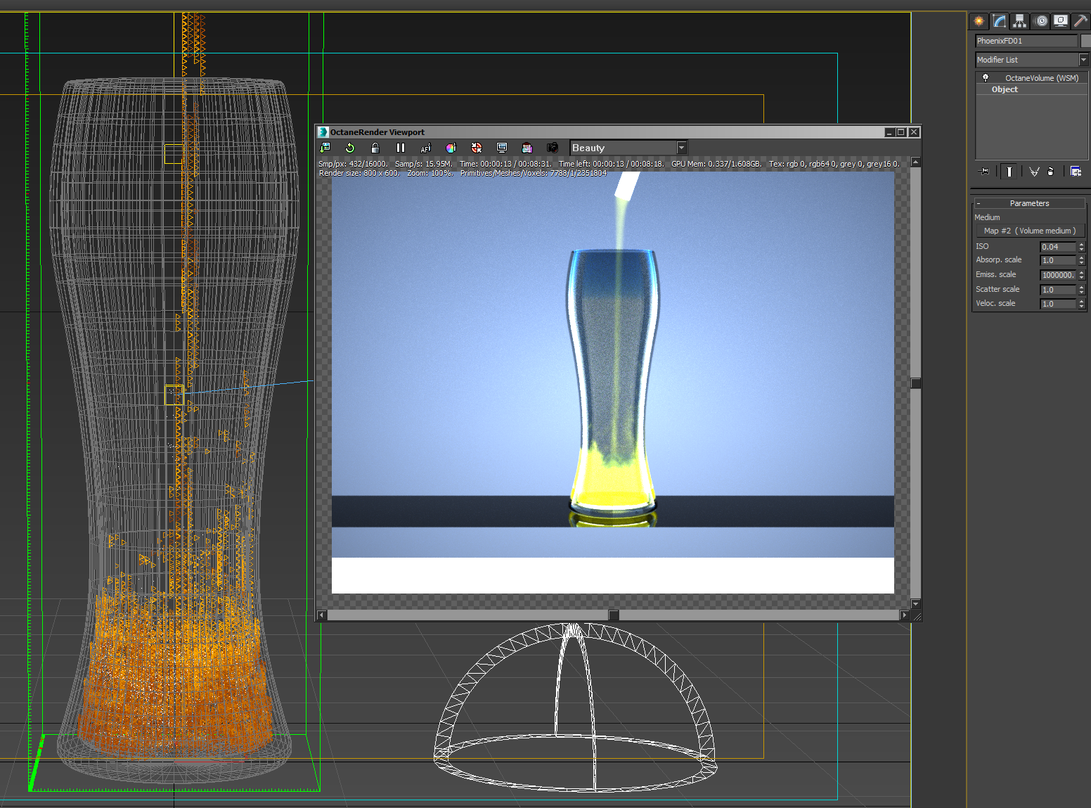

PhoenixFD is supported by Octane (in current TEST versions), and motion blur for its simulator object is supported too. But you can't talk about PhoenixFD liquids as "having non-static topology", 'cause they don't have any mesh topology at all. The PhoenixFD liquids are actually volume grids.
Octane rendering core currently does not support rendering a volumes as meshes with e.g. specular material applied. Currently Octane only supports rendering volume data as a volume. So, if you e.g. apply some emission to PhoenixFD liquid - it becomes visible, it will have a motion blur, but it will be rendered as a volume currently, not as a mesh - so it does not look like a liquid and it can't be used for that kind of rendering (see the example). I've just had a talk with haze (the guy who works on VDB subsystem in Octane core) - perhaps in later versions of Octane rendering core the volume subsystem will be improved in this regard, but currently Octane can only render the mesh data for this purpose.

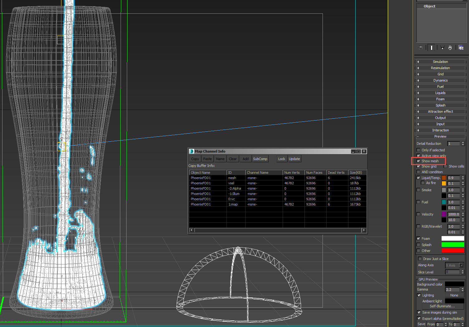

Oops, I've just checked and it looks like the PhoenixFD support implementation in current test versions has broken the opportunity to render its simulator objects by Octane as a meshes when "Show mesh" is checked.
I'm going to fix it in next version, so - if the PhoenixFD simulator object will not have the OctaneVolume modifier applied to it, it will be considered a mesh by Octane...
But even if the "Show mesh" option is chosen, I don't see any new channel that looks like a velocity channel for that PhoenixFD mesh... As I said - I've already implemented the support of 3ds Max standard channel data as a velocity-data, but I've not seen so far any 3ds Max objects that generate this channel-data. The only object I've seen - is a 3ds Max' standard alembic object, but it screws up this data during generation...
So, this functionality is currently stubbed in a plugin. As soon as I see at least one 3ds Max object that properly generates this velocity channel data - I will un-stub this functionality.
