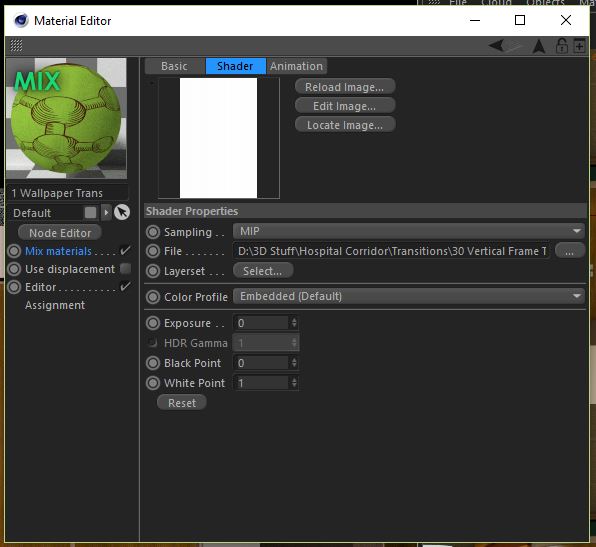

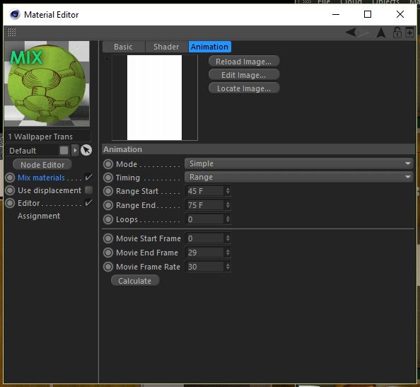

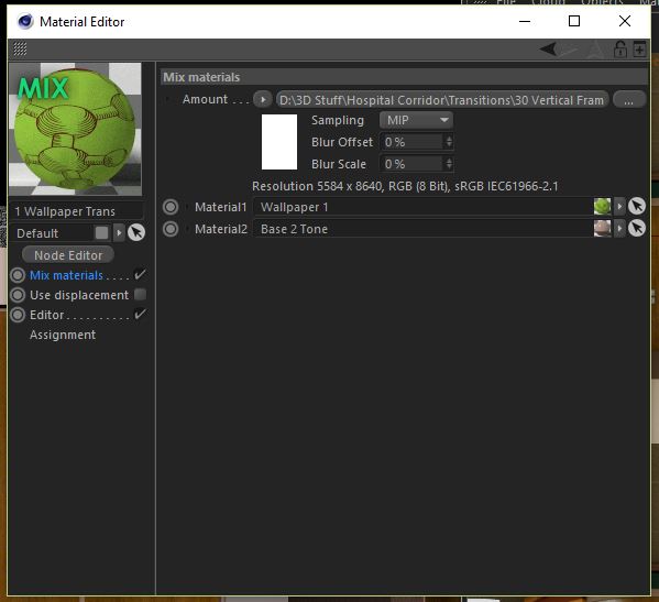

The way I accomplished it was to create my transitions in AE, export to a PNG sequence, then use that sequence in a mix material in the amount section. I've included screenshots of the material setup below. I've tried reloading the image sequence, deleting and re-inserting the sequence, and I've even tried using JPG and PNG as sequences, and none of them seem to work.
