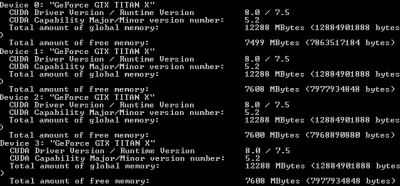

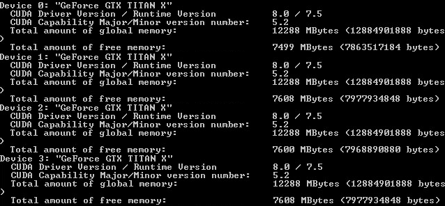

We recently upgraded to Octane 3.02. During one of our renders, we received an "out of memory" error message. This message never occurred when rendering with Octane 2.
The attached image is a composited screenshot from one renderbox (with four Titan's) when Octane crashed. The data is from a cuda program showing that there is plenty of free memory remaining on each graphics card.
What is most alarming, other than the "out of memory" error message, is that 48 GB RAM of graphics card memory maxes out at 12 GB RAM. If this is by design, why?!
Yes design and it's running on seperated devices(gpu) as parallel. It's answered here: viewtopic.php?f=98&t=55052#p282283[email protected] wrote:If this is by design, why?!
