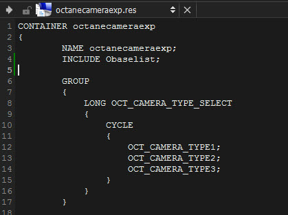

Ok. Only concern about that having lot of tabs in camera tag.
Here is how to add by yourself

I have changed the line 1 to 17 in all the 3 octanecameraexp.res files found in the octane plugin folder, is that correct? or there was only one specific file to change?
(by the way it works now, thanks)

only you need to add line4. No need to touch another files. I've changed in development version too.
