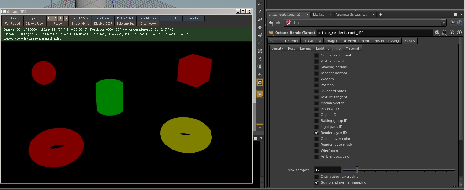

Well, at OBJ level you have the "Render Layer ID" pass. You can't set the RGB color for each layer, but at least you can group several objects in the same RGB matte.

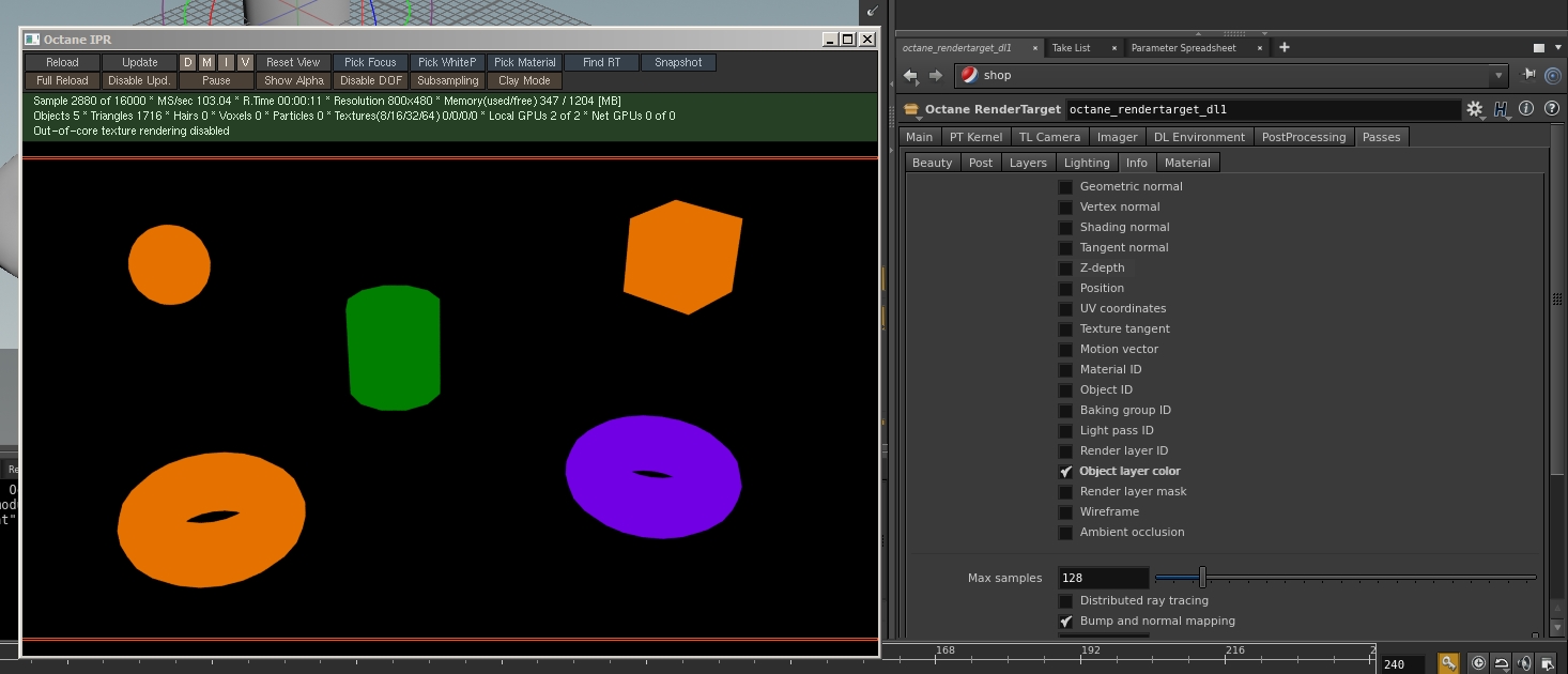

Or you can also use the "Object Layer Color" pass. At OBJ level you can set the RGB object color and group several objects in the same RGB matte.

sohara20
Posts: 71
Joined: Sat Mar 28, 2015 8:09 pm
yeah we are aware of these and as of now anything other than red green or blue becomes problematic so we are using a combo of Render Layer Color and Baking Group Id's which only gives us 5-6 matte separations total. Which in production is just not enough sadly.
