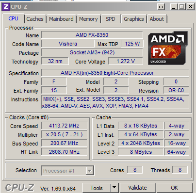

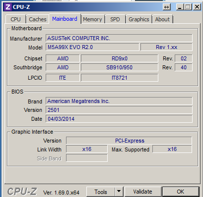

3.x when rendering large images 8000pix and more there is a system failure Windows blue screen of death during render is a slowdown in the movement of the mouse and sound) .... 2.x render all the good bugs .... I beg you to solve this problem as soon as possible ... maybe a conflict in my system but I have all the drivers updated .. 3Dmax 2016 SP3 /// errors in the system, no....
windows 7 64
590 780(6GB) 780 (6GB)
16GB ram
368.39
4.x (3.x)
I have enough memory but the picture is rendered during the rendering process comes crashing ... crashing may or may not happen 50 to 50

I also render high resolutions. more than you mentioned like 21.000px never have BSOD.
even on v3 and v4.0 test version. same nvidia driver 368.39
I have 32GB ram and And I have 2 titans + 680 for display. maybe memory is your problem. but BSOD are strange things.. I think either it's windows problem or hardware related.
Maybe 780 draw more power and your psu cant handle it.?
what is you psu?

Lying on the shelf collecting dust http://www.gigabyte.ru/products/page/mb ... -ud5rev_10 after replacing the motherboard the critical error disappeared
