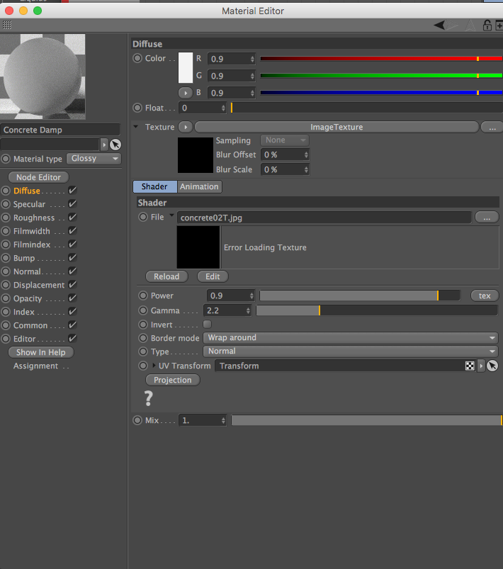

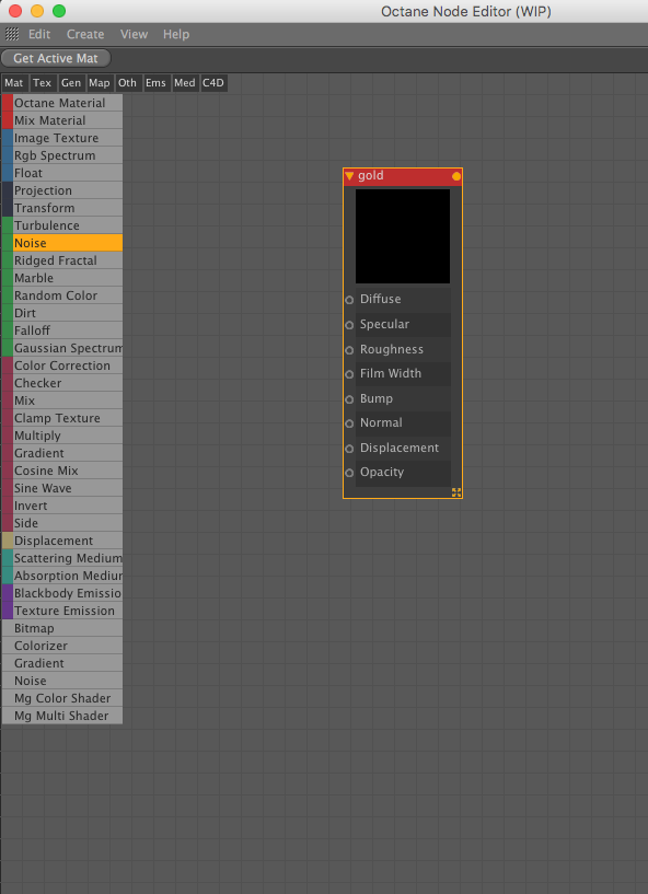

Hello
Anyone else have the problem of downloading LiveDB textures and finding that image files are missing? Please see attached pics.
Also, why don't I get a preview of the texture I am building in the Node Editor? Not a huge problem but it kind of irritates me.
Posts: 16066
Location: Türkiye
First try to work on a saved project. Livedb textures are stored in project tex directory. Second try when LV is rendering the current scene.
