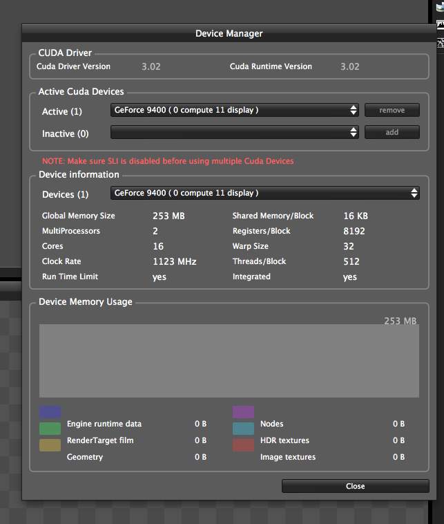

So I went and downloaded the demo of octane hoping to buy soon, but when I installed CUDA 3.0 it said it was not installed and failed to open at all. Just to see what would happen, I downloaded and installed CUDA 3.2 and this time octane opens but when I add an .obj node and click to render, it crashes instantly with no render report or anything.
I am fairly new to the graphics cards and stuff but I have a GeForce 9400 and I took a screenshot of the device manager just in case it would help (I noticed it thinks cuda 3.0 is installed while its not btw)

We have a Mac mini here with exactly that graphics card, so you should be able to run Octane on it. But first, be warned: Octane runs really slow on it, because this GPU is very very old.
To test the demo version, please install:
- the CUDA 3.0 toolkit, which you can get from here: http://developer.nvidia.com/object/cuda ... loads.html
- the CUDA driver 3.0.14: http://developer.download.nvidia.com/co ... _macos.dmg
The CUDA driver 3.0.14 very likely won't work (at least it didn't here). If that's the case, please install the CUDA driver 3.2.17: http://www.nvidia.com/object/macosx-cud ... river.html
Don't change the CUDA toolkit, the demo version needs CUDA toolkit 3.0.
