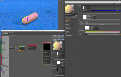

How can I map this gradient texture map from left(top yellow) to right(bottom pink) of this capsule object? Is this even possible within the Octane material UV projection settings? I feel like ive tried everything.

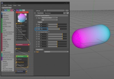

just use a transform in the saw wave with a Z rotation of 90, or if you don't want to use UV but projection, add this transform to you projection node.
