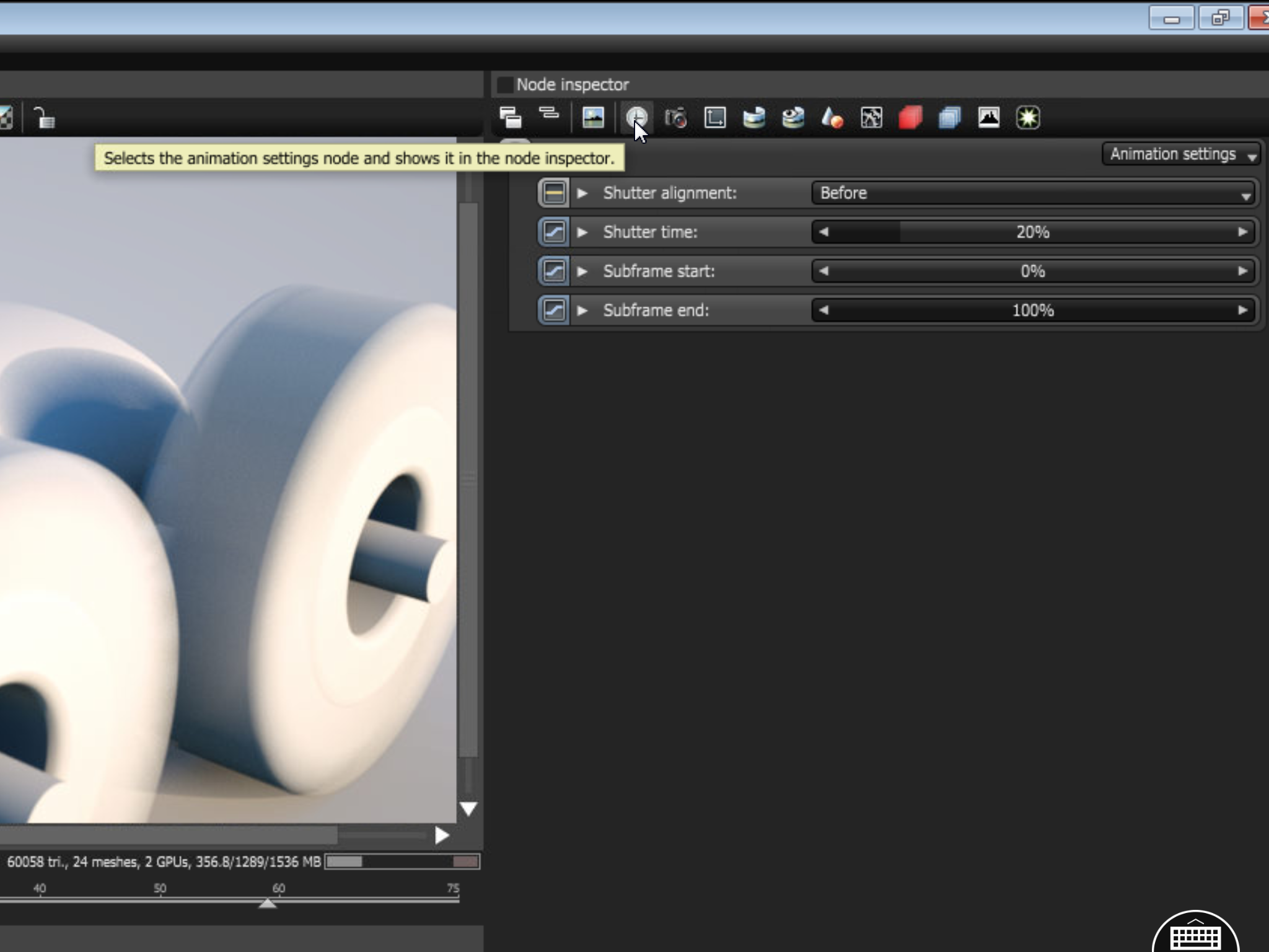

Here are some screenshot with different settings. But whatever value I put result is incorrect. Do you have correct result? If so, please, tell me what settings to use. In my examples, symetric settings (last image), gives correct MB but shrinking is the problem.
No motion blur:
Imageimage hosting 30 mb
BEFORE, Shuttertime 20%, start 0%, end 100%
Imageupload images free
AFTER, Shuttertime 20% start 0%, end 100%
Imagefree upload pictures
SYMMETRIC, Shuttertime 20%. start 0%, end 100%
Imageforum image hosting
