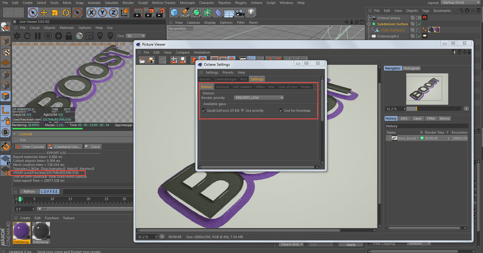

Posts: 16068
Location: Türkiye
Here what i see
VRAM used/free/max:1Mb/33Mb/6Gb
used+free should be at least 4.5 or 5gb. Here is 34Mb. This is very strange and i never seen this before. Here is what i see on my test render. Note that the red areas. I think there is some problem on your GPUS. But i'm not sure. Can you try on standalone. Let's see the gpu stats.
