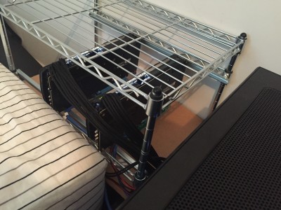

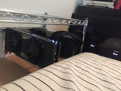

Hey Guys,
Thanks for all the feedback, really appreciate it.
This is my current setup, 4 980tis, two connected directly to the mobo and two external via usb 3.0 risers for better thermals. Sometimes it works beautifully others times i tend to get MACHINE_CHECK_EXEMPTION blue screens. Everything is powered separately. Both risers have molex connections. Im using it with a splitter though, perhaps i could try giving each riser its own power source, though i doubt thats the problem.
Will need to play around.
It's very uplifting to know that you are using them with success slepy8. Thats very encouraging. Im currently using some longer USB 3.0 cables to get some extra reach, Im curious if that has anything to do with it.
I'll keep playing around and let you guys know what results I get.
