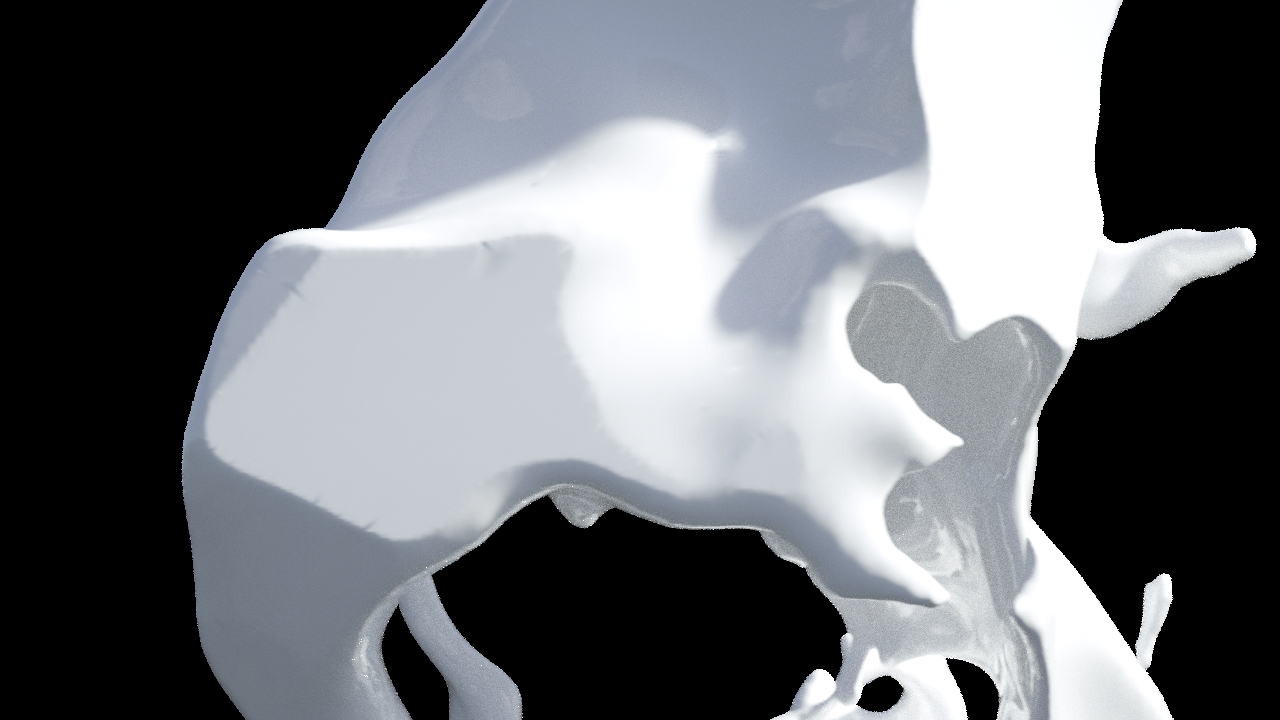

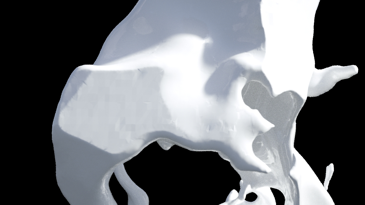

Here it is with deformation MB enabled:
and here without:
obviously fluids motion vectors are not very exact because the topology changes on every frame and the motion vectors are interpolated from a vector field. That leads to visible breakups on smooth surfaces. I could try to smooth out the motionvectors somehow but it would be nice to just render the mesh on frametime 0.0 to get rid of them. Or is there another option to smooth out the normals after motion blur deformation? Because setting the "smooth angle" in the octane properties doesn't affect this.
Do you still need the scene?
Thx
