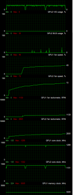

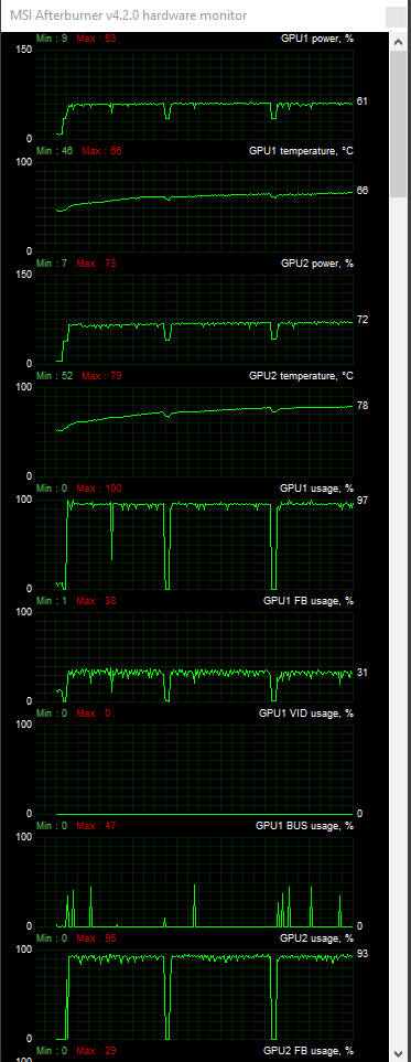

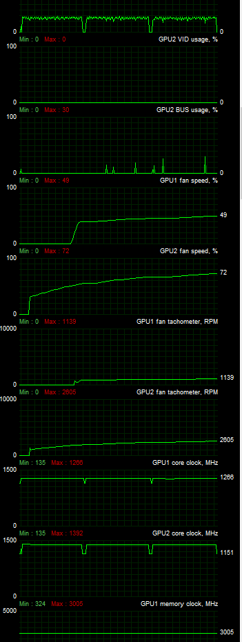

here is the octane log for this try, it happened immediately
And also added is the afterburner log for a second try, this has been rendering for 6 minutes now.
Nothing unusual as far as i can tell.
The actual error message goes away super fast, but yes it seems it is not octane related because the forum here does not mention it once.
On the nvidia forums there are a lot of people who have it but nobody seems to have a final fix
