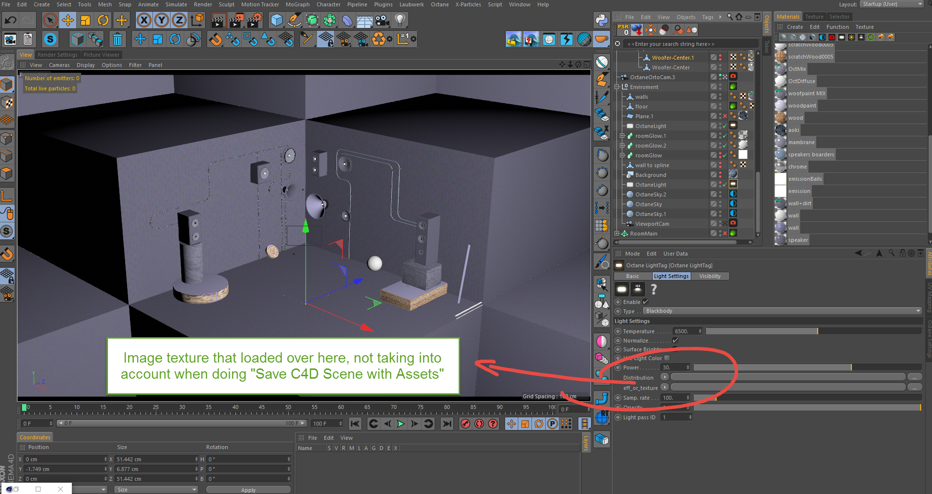

Small bug that exists for a while - While doing "Save C4D scene with Assets" for Octane live viewer. It all works properly. beside one thing:
The image texture that loaded inside the Distribution / eff_or_texture slot is not taking into account, and needed to be copied & connect manually.
Hope that an easy fix Ahmet.

I just checked it. It seems as working but copies the 'ies' files to target directory not to 'tex' directory. But copies other files to 'tex' dir. Can you explain more where is your images and where to goes?
Take a look at the simple video i made attached to this message.
It explains exactly the problem. the idle scenario would be that the "Save C4D file with assets" would copy also the texture inside the light to t relative path, like it do the all the textures.
Many times i need to send over my scenes and then manually go into the lights and change the paths to something relative.
Make sense?
Make sense?
