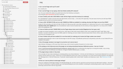

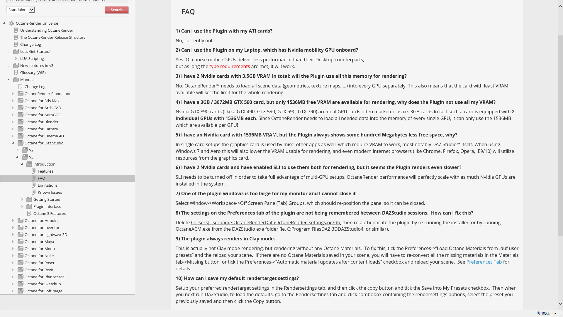

Have you checked question 9) at https://docs.otoy.com/#60FAQ?

face_off wrote:Have you checked question 9) at https://docs.otoy.com/#60FAQ?
Paul
The referenced question 9 is:
9) The plugin always renders in Clay mode.
This is actually not Clay mode rendering, but rendering without any Octane Materials. To fix this, tick the Preferences->”Load Octane Materials from .duf user presets” and the reload your scene. If there are no Octane Materials saved in your scene, you will have to re-convert all the missing materials in the Materials tab->Missing button, or tick the Preferences->”Automatic material updates after content loads” checkbox and reload your scene. See Preferences Tab for details.
Side Note:
The posted link defaults to the Octane for Rhinoceros FAQ section.
As far as I was able to check every single FAQ for any application that has a FAQ section now uses the same "external" URL
It seems the whole link system for the "OctaneRender™ Universe" section was changed lately.
I do not know if the web team is already aware of all the side effects this change had...

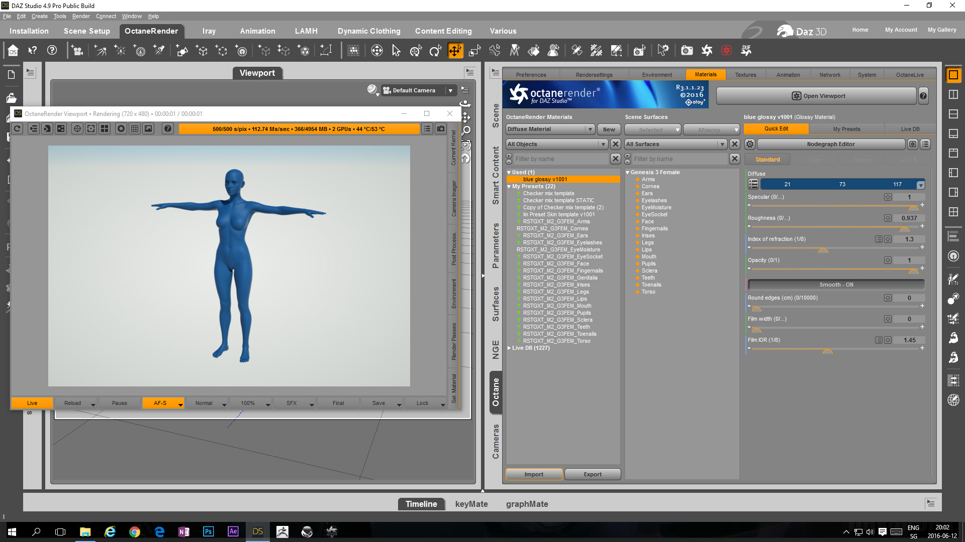

Test 01

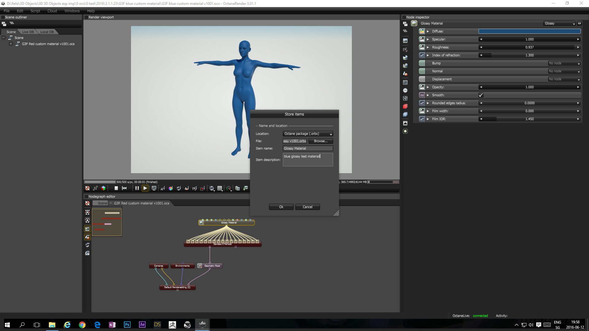

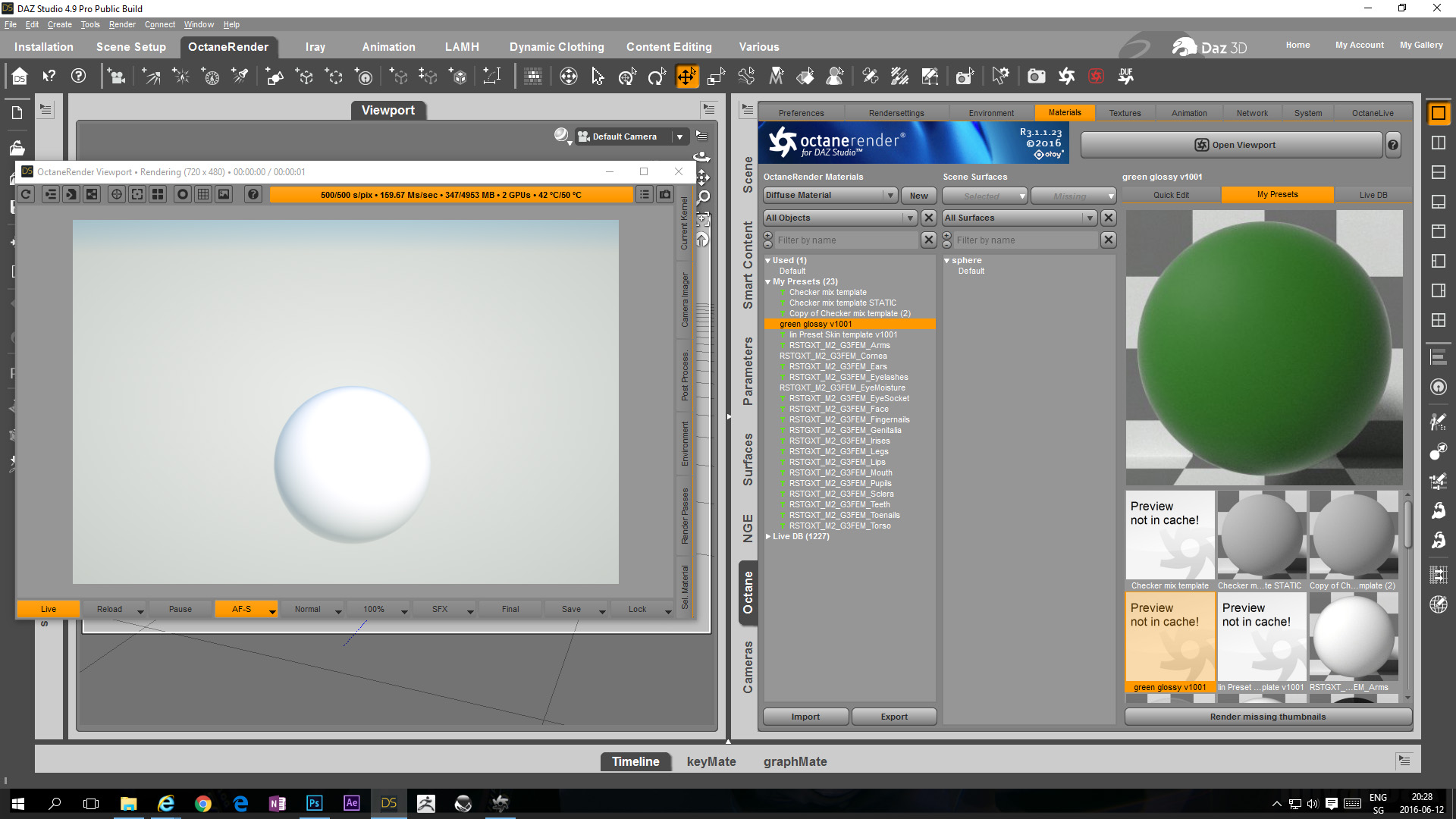

- 1 Create Custom material in OR standalone

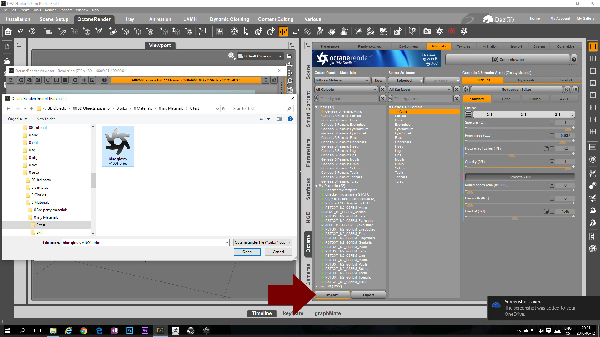

- 2 Import Custom material in OcDS
- 3 Imported custom material applied

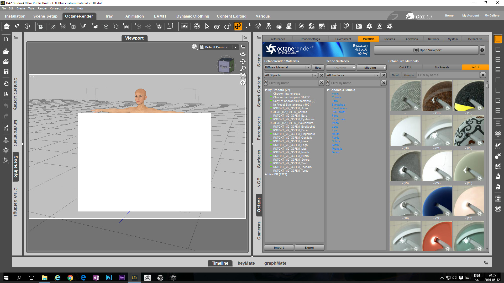

- 4 save scene
- 5 load scene
005 Scene after loading - imported custom material was not saved with scene v1002.jpg
-> Scene state after loading - imported custom material is missing from the OcDS materials tab
No materials are applied.
Test 02:
As a potential workaround I tried to
- I) save a different imported .ORBX material (green) under "My Presets"
- II) close DAZ Studio
- III) open DAZ Studio
- IV) try to apply the previously saved material from "My Presets" to any surface
007 user preset based on imported custom material cannot be applied to any surface.jpg
-> Even though the green imported test material shows properly on the preview sphere it cannot be applied to any surface in OcDS.

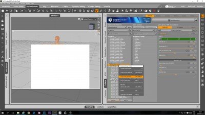

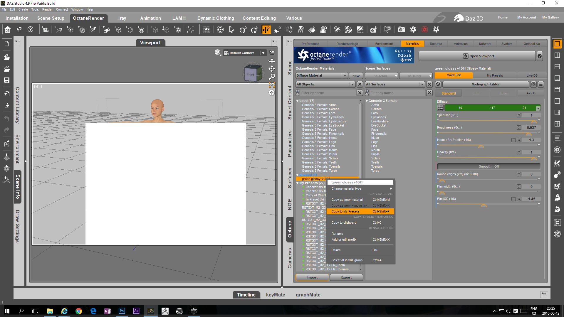

An update on this issue...
When you use the Import button the material is imported, but will not save with the .duf because it is not registered in the data that is saved in the .duf (for reasons that are difficult to explain). After a few days working to try to resolve this I cannot find a solution. A workaround is that after importing the material, you rightclick the imported material and "Copy as new material", and use the copy - and that copy WILL be saved in the .duf.
So an option to progress this issue is that whenever you Import a material, a popup dialog is displayed "You need to 'Copy as new material' in order for this material to be saved in the .duf".

face_off wrote:An update on this issue...
Your thoughts pls?
Paul
Thank you for investigating and coming up with this workaround. Would not have thought to try that....
Did a quick test with the blue material posted in this thread and the described workaround seems to work
- when applying a copy of the imported materials
- when adding a copy of the imported materials to "My presets"
-> Having to use "copy as new material" may confuse new users at first but after you know the trick this seems not that much of a hassle.
