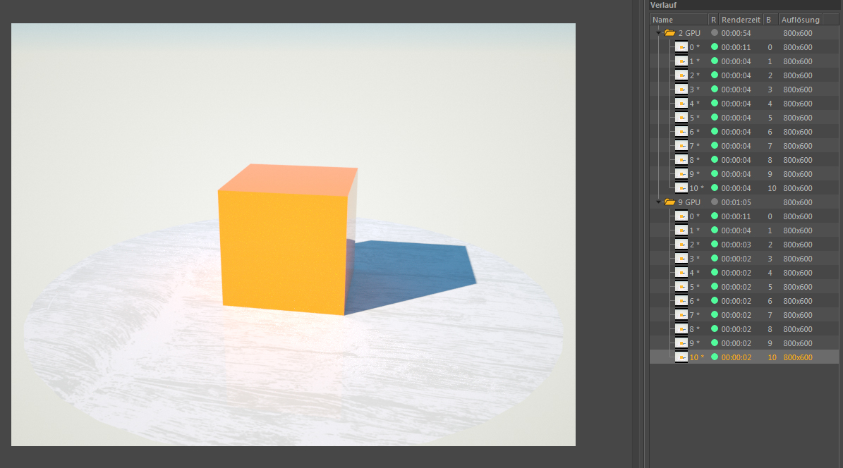

Here is a Screenshot (its a extreme Example) but one Case....
Dont forget my 2 GPU's are 780, not 980TI like my Renderslave.
Sooo...one GPU needs ~8 Seconds.
With 10 GPU i have 10 Frames in 8 Seconds.
As u can see, my Renderslave needs with 9 GPU's (~2 Seconds/Frame) 20 Seconds......
