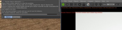

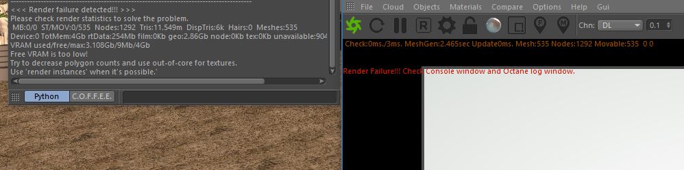

Nobody answers here? What a bad support...
Same issue here (and many others that makes me thinking about moving to another render)
<<< Render failure detected!!! >>>
Please check render statistics to solve the problem.
MB:0/0 ST/MOV:0/535 Nodes:1292 Tris:11.549m DispTris:6k Hairs:0 Meshes:535
Device:0 TotMem:4Gb rtData:254Mb film:0Kb geo:2.86Gb node:0Kb tex:0Kb unavailable:904Mb temperature:45
VRAM used/free/max:3.108Gb/9Mb/4Gb
Free VRAM is too low!
Try to decrease polygon counts and use out-of-core for textures.
Use 'render instances' when it's possible.'
Hi davidro,
sorry to hear that you are having issues with c4doctane.
In your case, if you read frough the error message, you can see that you have reached the limit of your system with 4GB of VRAM.
With more than 11 million polys and assets, the scene is taking more than 3GB, and you have only 9MB free, because 904MB are used by system and monitor.
As also said buy the log:
ciao beppe
Or switch to another GPU with more VRAM.Free VRAM is too low!
