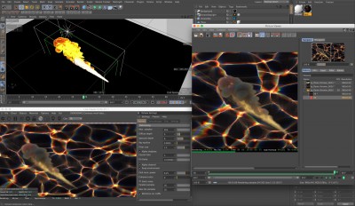

Hi, I try to create a fire + smoke test in order to render a sequence with alpha.
I just want the fire + smoke visible on a transparent background. In the LV it works but when I render the sequence, I have the background visible with my fire + smoke with the same parameters of LV.
I don't understand why...
an idea ?
thanks guys

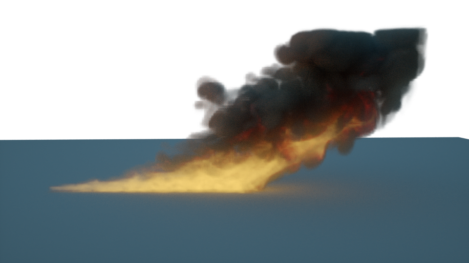

Posts: 10622
Hi bertritude,
there is no issue with TFD and alpha here, this frame is rendered in the Picture Viewer from the Ahmet TFD example:
Please double check your render settings, I guess that there should be an issue there :roll:
ciao beppe

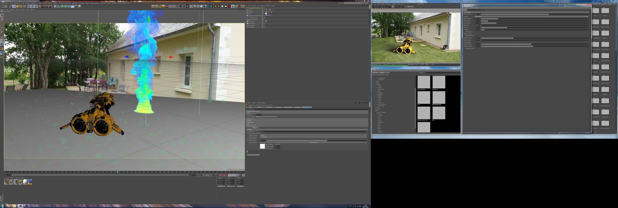

I tried a 3D tracking scene,
So, I have a look and If I tick the alpha channel in octane settings, I see my animated background the round base for my fire but not the fire itself ine the liveviewer.
If I untick the alpha box, I see a black background and the ship and the full fire this time (my animated background isn't visible now)
Is there a way to have all ?
thanks guys

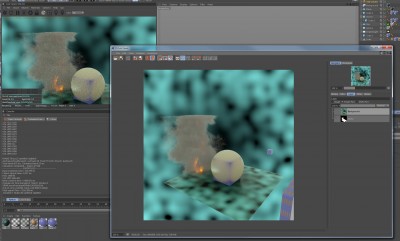

Posts: 10622
Hi bertritude,
apologize for the crazy screenshot, but I have picked up the first animated texture on my hd :oops:
and here everything goes as expected even with an animated background :roll:

Posts: 10622
Hi bertritude,
it's exactly the test that I have already done, there is a c4d material with an image sequence in the color channel. The LV shows the 29th frame while in PV is rendering the 30th frame. If you look carefully, the background is different between the two ;)
Weird, I have no idea why you cannot use the alpha channel option :roll:
Could you share one of your scene?
ciao beppe
