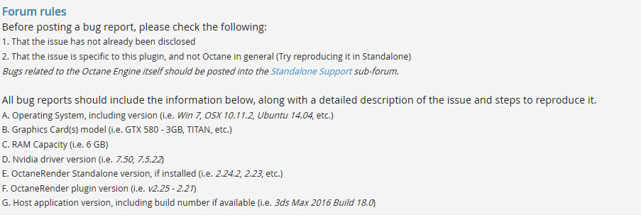

C. RAM Capacity (i.e. 6 GB)

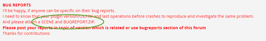

These are our request from you while you post the issues. Please don't ignore these if you wish to get it fixed. This is very usual way which is done by any other companies. Otherwise i'll unintentionally have to ignore some posts.
If you are not having bug reports due stucking please send a scene and explanations to allow us to reproduce same problem.

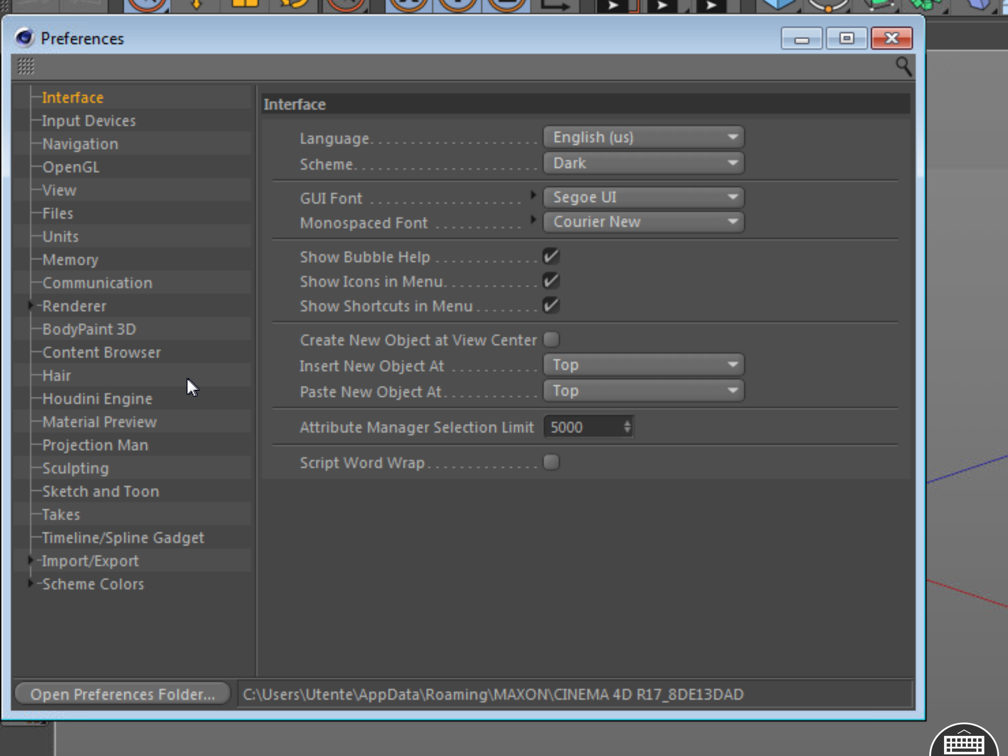

Hi Ahmet,
Can you expand this request to show where to find the proper log files on multiple systems?
Thanks,
daniel

Hi daniel,
the easiest way to find the bugreport.zip file in different systems is to open c4d and go to Menu/Edit/Preferences. Then click the "Open the preferences folder" button at the bottom of the window and navigate in the _bugreport directory:
ciao beppe
