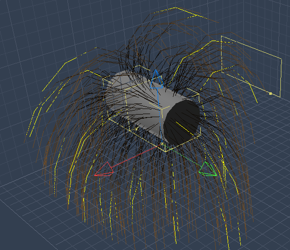

Also, is there any functionality with the vertex hair simulator as shown in the attached image in earlier or this current Octane version? I cannot get it to work, encounter crashes and blank renders.

Octane support for Particle Emitters is limited to mesh objects. The API does not provide any access to the point information for the other types of emitters so I cannot implement any other kind of support.
I am not aware of any hair issues. Can you post your sample scene?

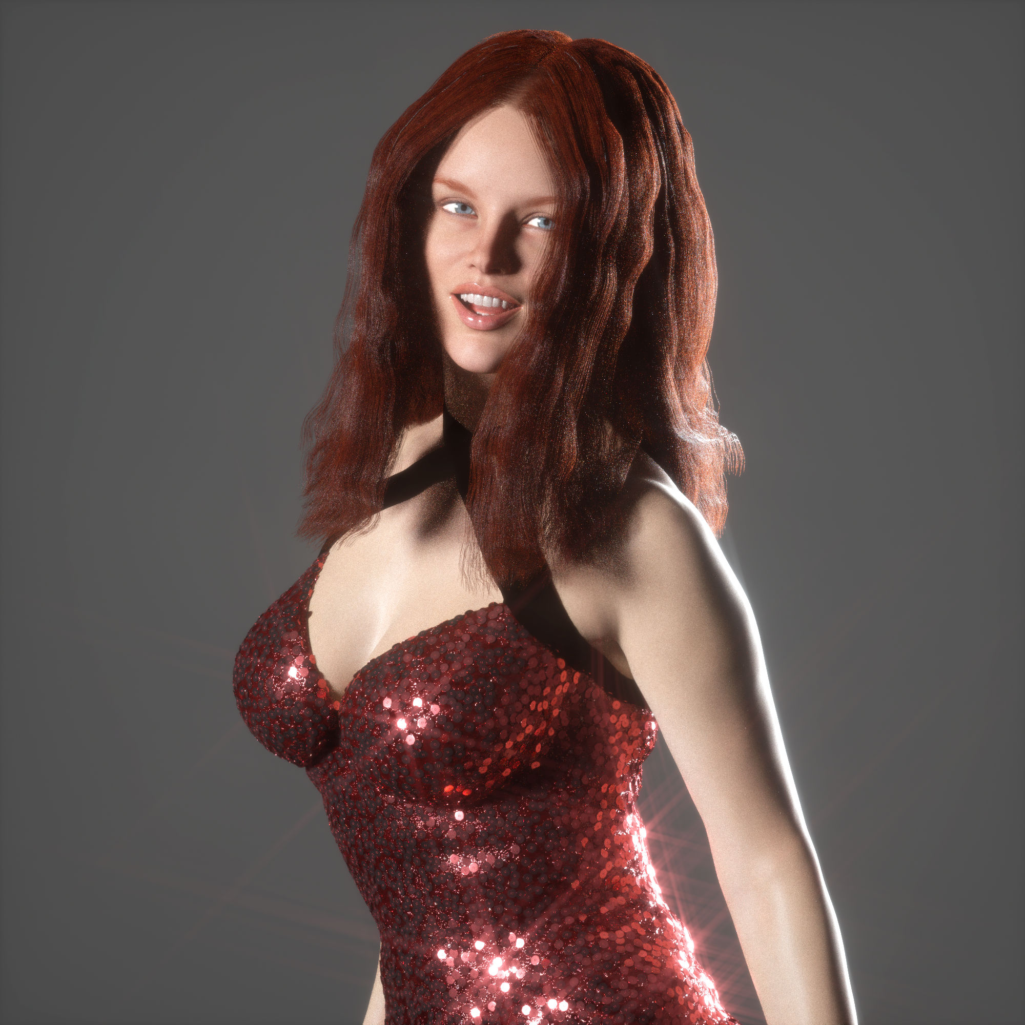

I have no issues with using Carrara's dynamic hair with OR4C if that is what you mean. I have attached a recent example, this also uses 8000 replicated sequins on the dress.
