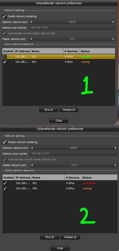

Well here's a picture of some of the slave-issues.
Most of the times when rendering to picture viewer (attached image) one of the following occurs
(1) one of the slaves unchecks itself
(2) one of the slaves crash
On the issue regarding the manual I noticed it now says v3, but still far from complete. In addition to missing information stated earlier, there's also missing information on most Octane shaders.

preciousillusion wrote:And then there were silence from Otoy... For 3 weeks

Some crashes are completely random. Regarding the crashing slaves, I've stated quite clearly when they occur. Stop live view, start "render to picture viewer", that's when slaves crash. Or uncheck themselves.
