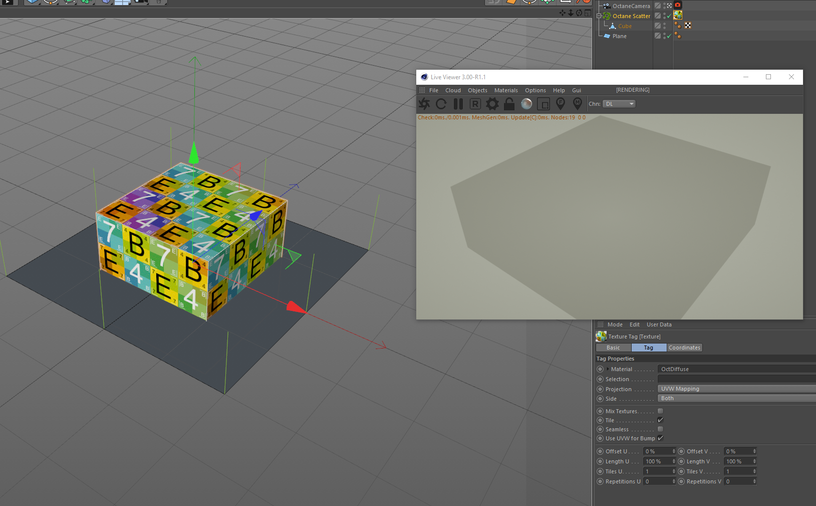

It will be nice if the c4d octane Scatter could accept material, like cloner.
I try to UV camera project a video over my scatter scene.
Thx

Please check the image in attachment.
The materiaux on my Octane Scatter don't appear, you know why ?
I am on V3.
(i want make a camera uv projection over, that why i need it on the Scatter and not on the Cube)
Thx

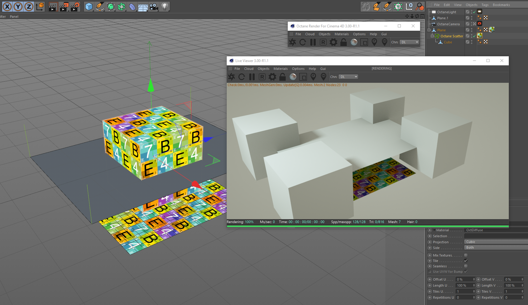

Put plane after scatter. Scatter doesn't work if distribution object is not polyon and before that.

i don't understand : "Put plane after scatter"
Look what i done, it still doesn't work.
Can you give me more details about your method aoktar ?
