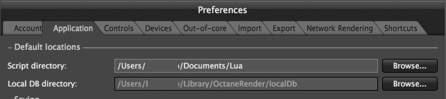

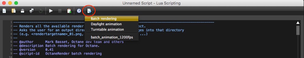

Thank you Beppe. I can run your script, but as I am not so familiar with scripts (I am back to Octane after few years), is there a way to change batch script permanently (or where to find default batch script)?
Posts: 10622
Hi daco,
you can inspect and modify the internal batch script by clicking the "Inspect Octane script" buttton in the Script Editor:
But you have to save it in a different location if modified, possibly in your script folder that you can specify in Preferences/Application:
In this way, the modified script will appear in the Script menu just below the internal ones:
ciao beppe
