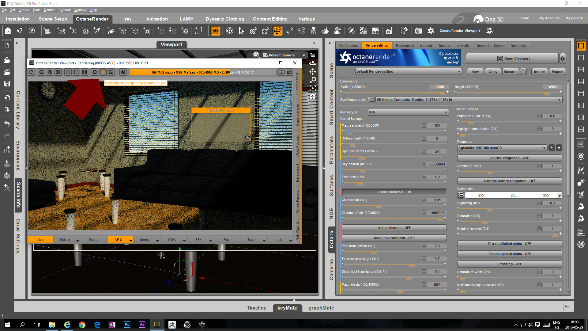

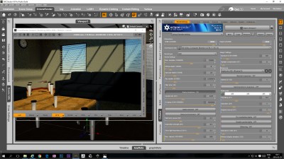

Example: Three regions were selected to focus rendering.<br />Can you still spot them? ;-)<br />Now the render is continuing normally again after region rendering was turned off

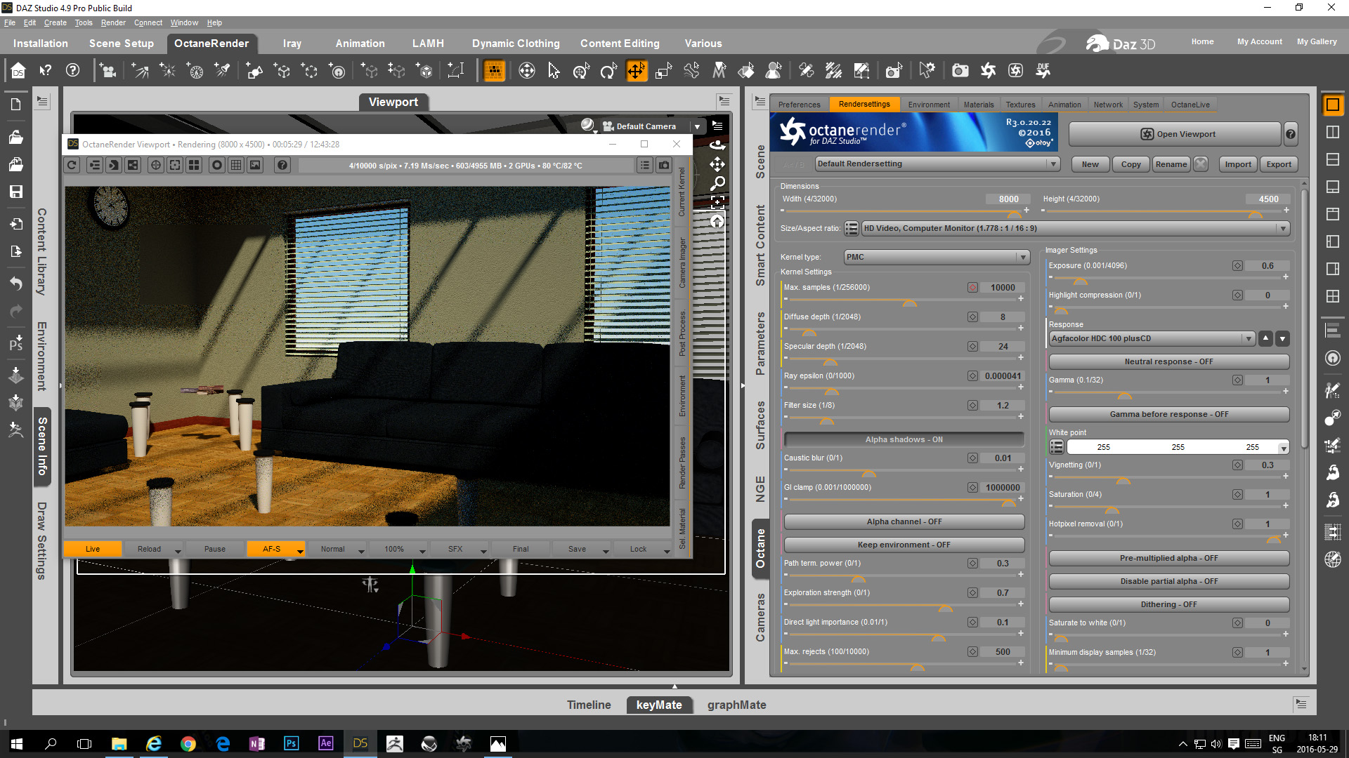

- You can task the same selected Region to render even more samples
Open the OcDS "Rendersettings" tab.
Kernel Settings - Max samples add a higher number like "1000"
Now an additional 1000 samples will be completed in the selected area.
