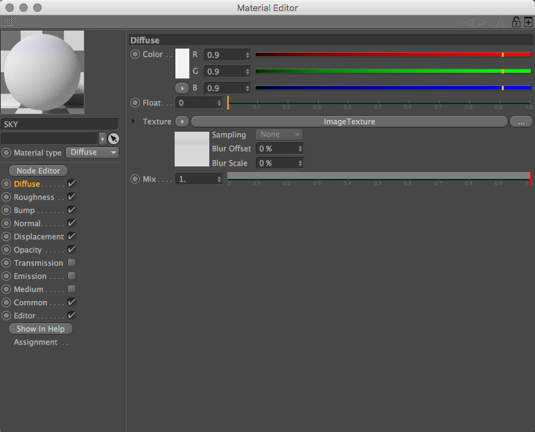

I can't post the scene, as it's a client project.
The crash only occurs when liveviewer is being used. And only when clicking back from live viewer to the C4D timeline.
The background object does have a psd texture loaded. It's in the appropriate octane channel.
The background object was disabled from view in the viewport, but not from render.
Screen grabs attached
