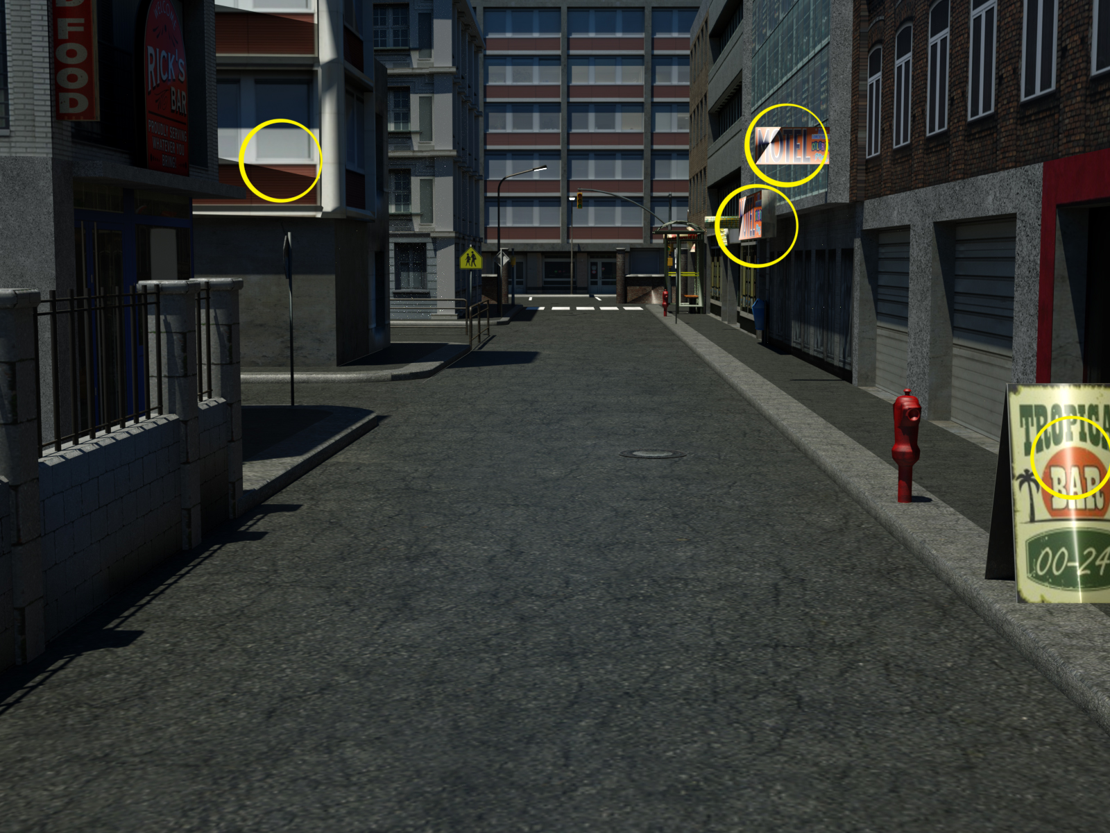

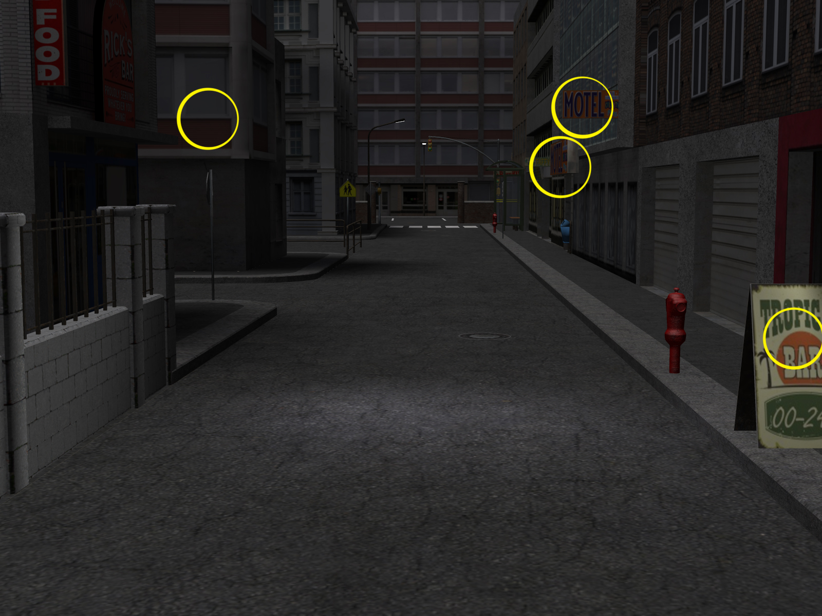

I meet trouble that strange specular result of low pol Obj.
Please advise about how to solve this.
If you need this sense, you can download this sense from following.
https://s3-ap-northeast-1.amazonaws.com ... rouble.zip
Poser FireFly Result
Octane Result
Octane Result

At a guess, I would say the normals on the geometry are not valid. The easy way around this is to material pick those materials, and turn Smoothing OFF.
