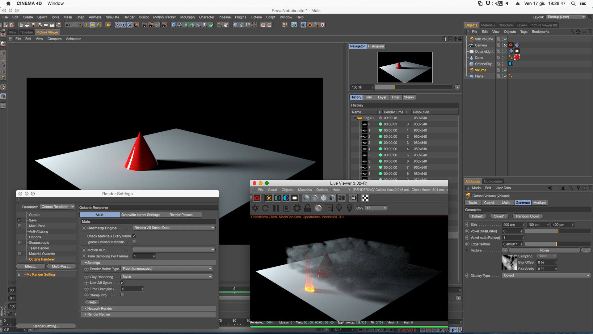

Hi, Ahmet!
I'm unable to render any fog box. I can see it in LV, but not in PV... Maybe somethings is wrong.
Could you help, me, please?
I set a very simple scene: a plane, and a Octane Fog Volume obj...
Thank you
L.
PS I can't render the V3 example scene... just vdb-fireball1, at the moment...

It's the same...
Here's a screenshot.
L.

Posts: 16068
Location: Türkiye
It doesn't work with "send all data". Why do you use it?

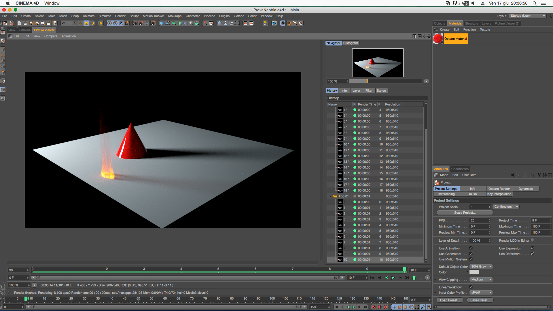

lucioing
Posts: 229
Joined: Wed Feb 19, 2014 4:01 pm
Location: Rome - Italy
...because checking 'only update ' it was not working.
Using 3.02, is rendered only the flame...
L.

Posts: 16068
Location: Türkiye
can you save and post this scene because it's working fine on everybody i asked.

Posts: 16068
Location: Türkiye
Thank Lucio,
i could reproduced that but it's belong to OSX version. Pfff i'm checking.
EDIT: I have found the issue. It was overlooked part in code and osx compile was revealed this bug. But windows build was fixed by MS compiler. I'm gonna put a new build as V3.02-R1.1.
