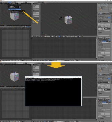

this kind of behavior might indicate problems with texture paths - either lost or containing non-English characters, but please post the error message (Window > Toggle System Console) so that we know more details.

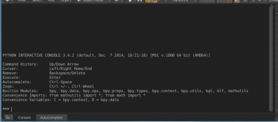

System console shows no error. Actually it always stays same, If I look at the correct place.

From your description I can only tell that I haven't ever had such a problem, unfortunately. Let's just see what System (not Python) Console says - go to Window > Toggle System Console when the problem occurs.

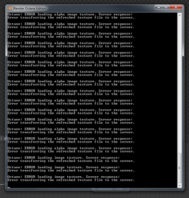

tamerkseniya
Posts: 66
Joined: Fri Apr 15, 2016 5:30 pm
Oh, forgive my stupidness :D
Yes it says Error in loading image to server. It does same thing for different textures, with different sizes etc. I checked names, they are all regular characters.

kubicki3d
Posts: 87
Joined: Thu Aug 15, 2013 7:37 am
Location: Bydgoszcz, Poland
I made a quick test and put a correctly named texture into a folder with some Polish characters, and System Console gave me the same message - I suggest you check all your folder names as well, it's probably best to avoid non-English characters in everything Octane-related...

tamerkseniya
Posts: 66
Some of my texture names had space instead of underscore, that might have caused problem as well.
Also thanks to your suggestion to check console, I found out about the main cause of problem. I was working in office from the server. I packed the model and copied it to local HD, this Error didn`t appear again. So I think server connection somehow interferes with Octane server, it is best to work on local storages.
