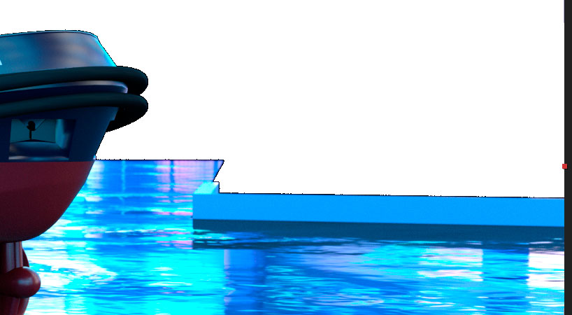

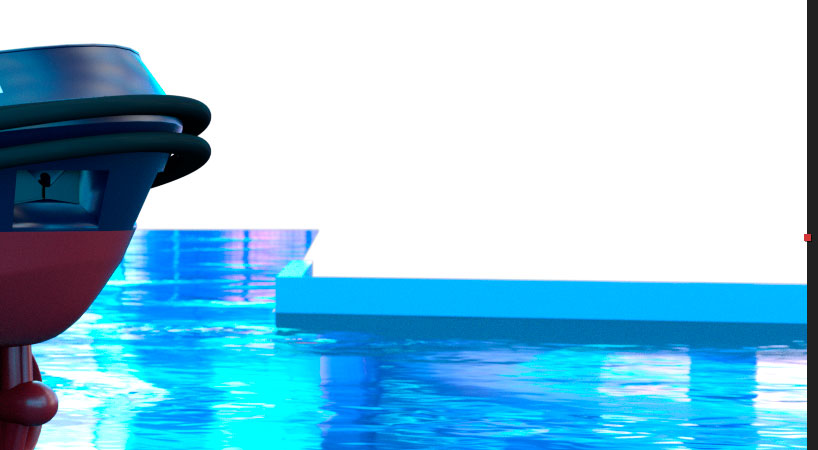

Hi! We just upgraded to Octane 3.0 C4D Pluging. I was testing scene with same settings that was working with 2.2 but now with 3.0 we are getting a black jagged edge con the alpha. And it is not usable for us. Please see the attachment.
Octane 2.25 (Good edge)
Octane 2.25
Octane 2.25
Octane 3 (black jagged edge) same scene, same configuration, just different render engine version.

Just investigate combinations of alpha enable, keep environment in kernel settings. Premultiply alpha, partial alpha in imager. And saved image with alpha.Also be sure that you're using proper software to check results.

Fixed! I just unchecked "Disable Partial alpha" on the Octane Camera tag. That did it. Thanks for your time.
