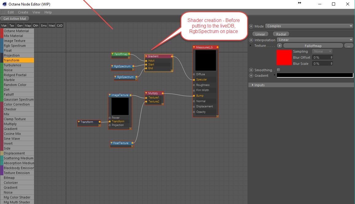

When putting texture into the liveDB containing gradient node with RgbSpectrum connected (like the images attached)

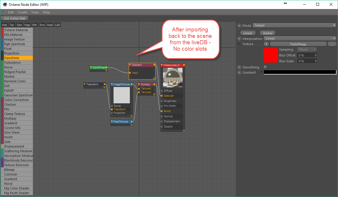

While loading it back from the liveDB the RgbSpectrum nodes are gone. the material still looks the same but it is not possible to change the colors.

Use "simple" as a work around. will be fixed if it's possible.
Yes, simple works, but sometimes i'm doing it like that for better flexibility with other nodes.
Thanks anyway.
Thanks anyway.

There is not same properties of C4D on Octane side. So plugin try to decide how's that.Yambo wrote:Yes, simple works, but sometimes i'm doing it like that for better flexibility with other nodes.
