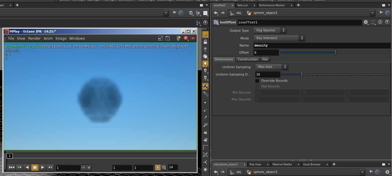

Weird, I can't reproduce the crash here. Anyway the main issue is that you must set a name for the volume grid in the volume SOP node, as you can see in the attached image ('density' is the default one used in the OBJ volume spare parameters)
The crash problem can be other issue. Can you render scenes without volumes? Also if possible, enable the log file in the plugin render options and send it to me to know where the plugin is crashing.

Yes, i can render without volume, and setting the name to density actually does fix the crash and does render fine.
