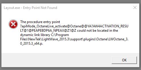

I'm struggling to get this up and running - first time I've hit a problem with a LW Octane plugin install. The attachment shows the error when I click any button in the Octane tab in 2015.3 (Windows). I cleared out the previous version too.

JBT27 wrote:I'm struggling to get this up and running - first time I've hit a problem with a LW Octane plugin install. The attachment shows the error when I click any button in the Octane tab in 2015.3 (Windows). I cleared out the previous version too.
It seems that you are mixing old Octane.dll/.dat files with the new plugin .p file. Can you please check again that the plugin and the Octane.dll/.dat files that you have in your system are all updated from the production build .zip file?

JBT27
Posts: 2
Joined: Tue Apr 15, 2014 9:55 pm
Thanks Juanjo - yes, I got files mixed so it seems; that'll teach me to do that late at night after a confused day :lol:

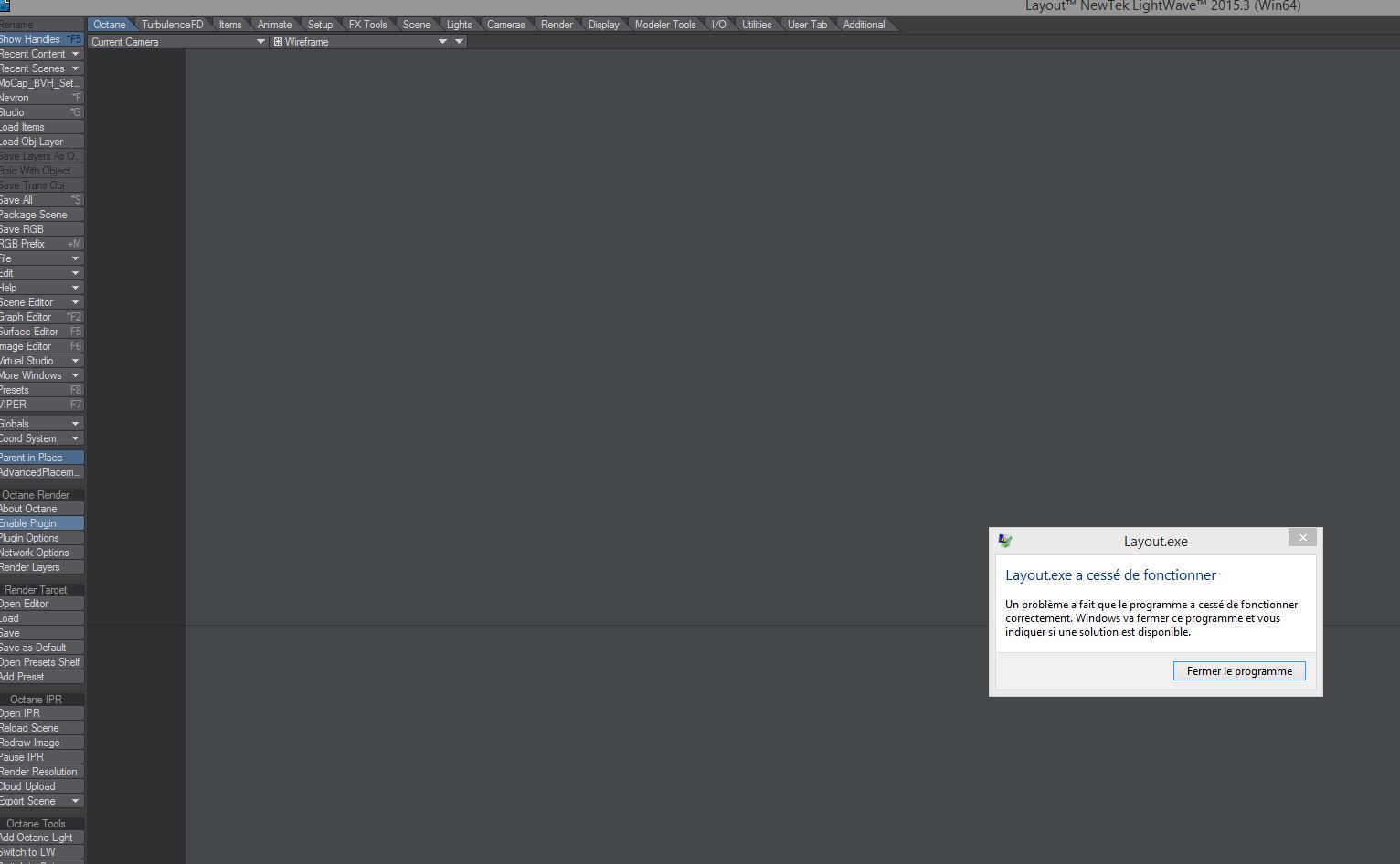

vipvip
Posts: 726
Joined: Fri Apr 22, 2011 9:28 am
I've just jumped to V3 version :
BIG CRASH when validating the "enable plugin" menu (see attached ).
I've installed the right plugin version and DLLs (x64 win on windows 8.1 64bits) ), have desactivated the V2 version and activated the standalone V3 before. In lightwave , the v2 version was properly uninstalled before installing .p and DLL of the V3...
i've reboot my computer, tried again, but still direct crashes ... (the alpha version, some monthes ago, worked without any problem...)
Please help !

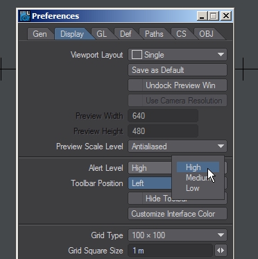

juanjgon
Posts: 8867
Location: Spain
Can you please set the Layout alert level to "High" and try again? You should get some information windows about the plugin initialization system. Please let me know at what point the plugin crash.
Thanks,
-Juanjo
