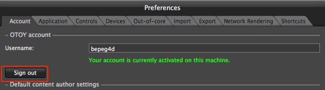

Posts: 10636
Hi guys,
Lucio's issue is solved ;)
please, start v3.00 Standalone, go to Preferences/Account and I sign-out from there:
In this way you should be able to deactivate your v3 license and activate the beta version.
ciao beppe
