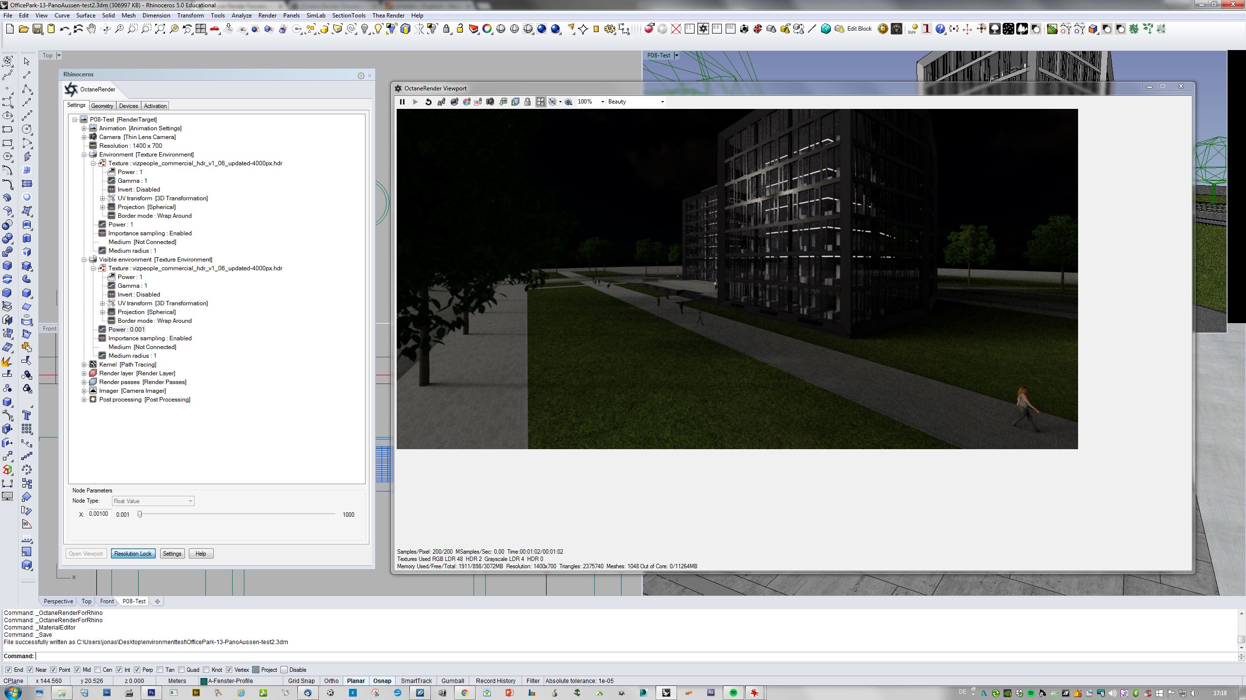

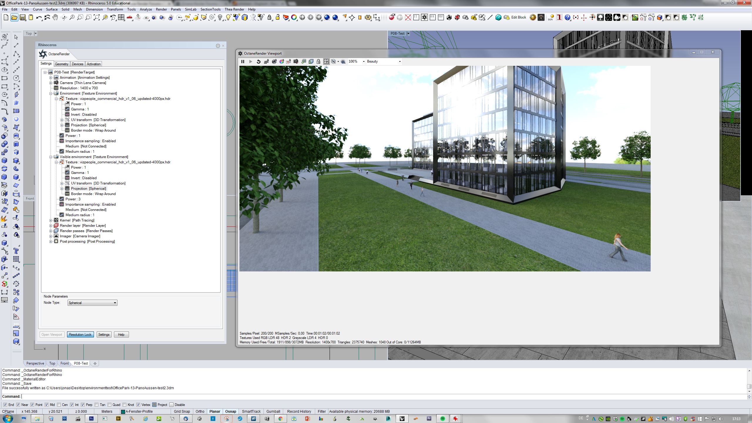

when I read that octane had been provided with a new option (visible environment node) to control the influence of the background environment, I was very excited because I hoped it would (partly) resolve some issues I had on a daily basis with burn out areas and alike , see:
viewtopic.php?f=9&t=52842&p=265977#p265977
I have been playing with the new option and although it seems to give you some more control, there are still a few things I do not completely understand...
From the official description I would conclude, that the multiplier of "environment" node is only responsible for lightning the scene, whether the "visible environment" node should only affect reflections and the background image in the octane viewport.
I did some tests and it seems that when I increase the visible environment node while keeping the environment node multiplier constant, the scene lightning also is affected ( please look at the shadow of the building in the attached images )
first image:
as you can see all multipliers are set to 1
second image:
I lowered the visible environment multiplier to 0.001, as a result not only the reflections are affected but it also seems that the areas that would receive diffuse illumination from the sky are way darker...
third image:
I raised the environment multiplier to 3, as before not only reflections and background are affected but the whole picture is lit more. There seems to be considerably lower contrast between shadow areas and areas lit by sunlight.
can someone please explain in detail how the two node are interacting ?
thank you very much in advance
Andreas

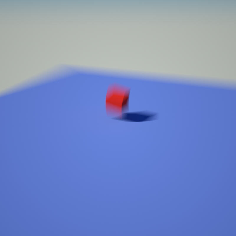

I think that motion blur is not working correctly, similar to the earlier situations in some alpha (or beta, not sure witch version).
abstrax
Posts: 5516
doca wrote:I think that motion blur is not working correctly, similar to the earlier situations in some alpha (or beta, not sure witch version).
Could you post an example, because here it works:
(camera and object motion blur)

hi Andreas,
The visible environment is used when a ray immediately hits the environment or hits the environment on path termination. For reflections and refractions we use the normal environment. For diffuse materials or rough materials, the situation is a bit more complex. When we hit one of those materials, we calculate direct light and trace a reflection ray, this direct light calculation uses the normal environment and the reflected ray uses the visible environment (if the reflected ray goes into the environment) hence the effect of both environments.
The idea is that you can use the visible environment to "hack" what is visible directly or for "clear" reflections/refractions of the background in materials (i.e. in a mirror or glass). We could tweak it for example that the visible environment is only seen when the ray directly hits the environment or used only for glossy/specular materials with low roughness. But we need to have a clear picture of what exactly is needed then.
cheers,
Thomas

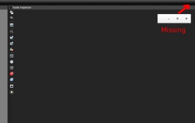

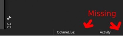

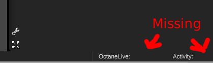

1: Octane Render 3 linux missing the button.
2: OnlineLive status and Activity does not appear.
What is the Status ?
Get no answer and it is not fixed ?
:evil:
System: Centos 7.1 Gnome.

We could reproduce this on a CentOS 7.1 installation. It might be the theme but I could not figure out how to change theme or it could be the user interface toolkit we use that has a bug and needs an upgrade. We're aware of this problem but we haven't figure out a solution yet.
cheers,
