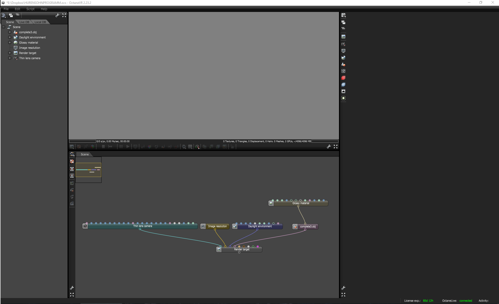

I am totally new to Octane and can't really find tutorials for beginners. Since there is no good usable student version of the c4d plugin I have to use the standalone version. I dont know what I am doing wrong, but why cant I see a thing?

Same problem for me. What GPU are you using?

Guys, to start the render, you have to select the gray node, the "Render target" node ... ;)
Actually I can't see it mentioned in the documentation, and this is an unconventional practice,
certainly you're supposed to dig in the UI a little, to discover this, the first time...
