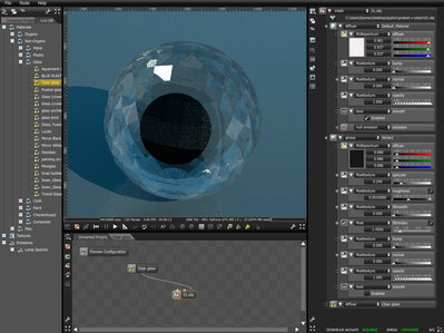

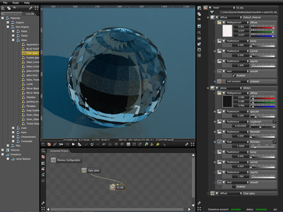

Hi, I have a problem with glass. I've tried to use a Clear glass from livedb, but it still not working. What I meen is, why light don't pass through the glass? Why on the other side is dark? For tests I use a two sphere one in the second. And here what I get:
Please tell me what I should change to get a normal window with a light on the other side?

This is not possible at moment with sun light, you need a mesh light or a hrd light.
We all waiting for this.
Cheers, mib

Thanks for your answer. I thought it's my fault
You make me calm.

Also check your path depth. Pathtracing defaults to 16 levels but for something as complex as your model, this may need to be increased.
