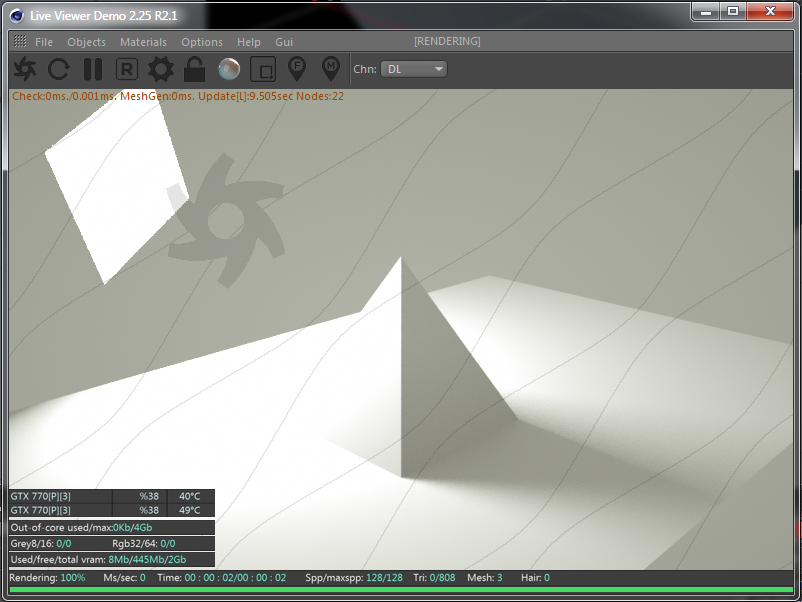

So I've been messing with the Octane demo for Cinema 4D. Fun stuff, but everything has this yellow tint. Where does that come from?
I figured it might be the default environment light that is slightly tinted. I can't figure out where to turn that off, but I get the same tint even when I enclose everything in a cube. It seems like it's just a general filter over the image, like a post effect, but I haven't enabled any of those.

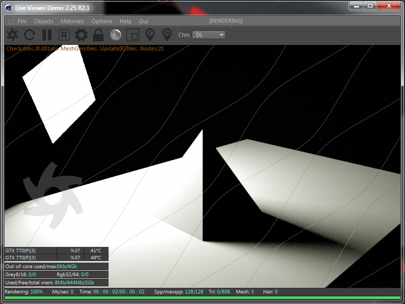

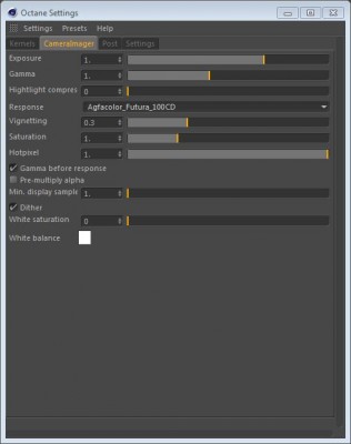

This yellow tint come from the camera response defaulting to Agfa_futura_100cd.
You can enable "natural response" to get rid of the tint, but to have a really neutral response select the "linear" profil and put gama to 2.2

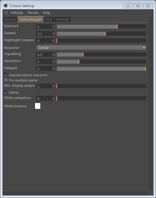

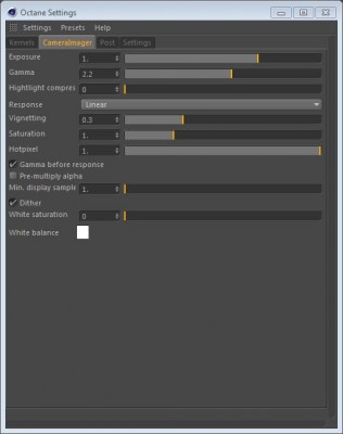

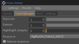

Hi DGruwier,
Octane starts with a default Agfa camera response curve that is not neutral:
Please switch to Linear response and change the Gamma to 2.2 for a neutral response in v2:
In v3 there is an option for Neutral response that can be enabled with any kind of response curve ;)

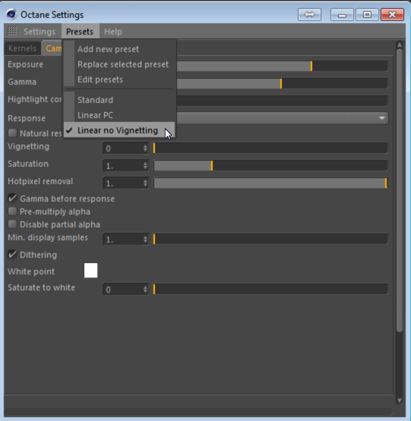

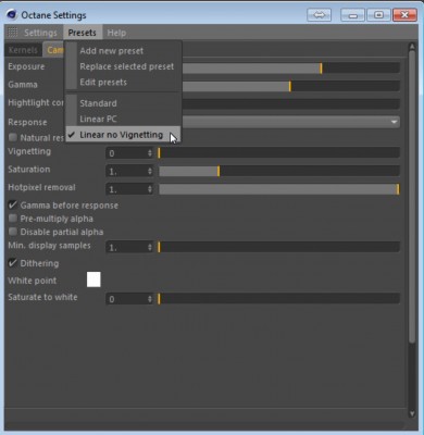

Posts: 10654
Hi Conor,
I don't have an exact answer, anyway it is set in this way from the very beginning.
Maybe to involve the user to play with the Camera Imager in real time :D

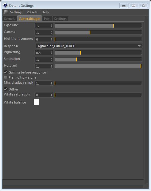

Anyway, in c4doctane, you can save several presets and recall them when needed:
And here is an article about the linear workflow and OctaneRender:
http://render.otoy.com/forum/viewtopic.php?f=21&t=33214
