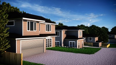

Hey guys, before I begin I've watch Dobromir Dyankov training on vimeo as well as their Understand Octane Render video and followed along nicely however I noticed that some images when rendered and showed on my monitor and laptop it seems fine however when I transfer them to my iPhone 6s the colors are all crushed as if the gamma were all set to 1.0?

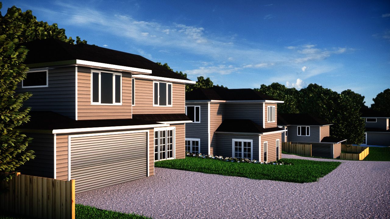

I've attached a sample render.
