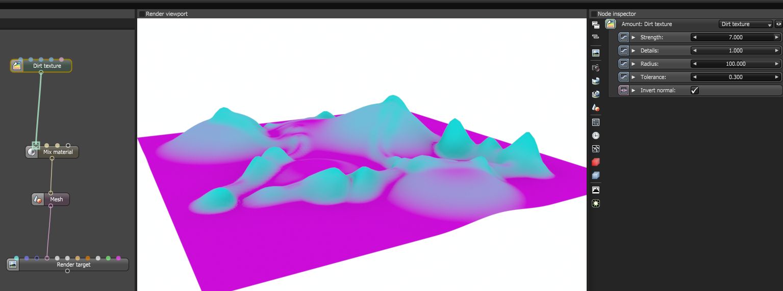

Maybe an OctaneDirtTexture with "invert normal" and used as a mask in a mix material, could help.

Thanks! It looks good indeed. :)

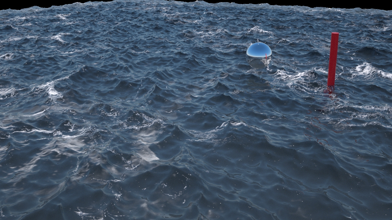

I try nothing special or critical. Just a generic and versatile solution for Z-Falloff which works in animations too. Like snow on rocks or trees, rain/wet surfaces and sea foam which appears on to of the waves. For the waves it would need some foam too at the spot where the object meets the water surface.
